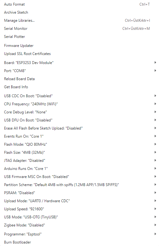

I still see the board in the COM list, though. Should this happen when I use the USB-OTG connector?
lbernstone
Posts: 1132
Re: Cannot get USB and MIDI Serial work at the same time
Postby lbernstone » Fri Dec 13, 2024 4:15 am
What version of arduino-esp32 are you running? You are missing the option for USB mode.
What you really want is to have HardwareSerial not attach anything to the USBSerial. If you look at the code, what you want is CDC boot turned off, and USB_MODE set to OTG (but not activated in code). These options have changed over time, so you really need to be on a fairly recent version for this to work.
wakeup
Posts: 5
Joined: Wed Dec 11, 2024 9:09 pm
Postby wakeup » Fri Dec 13, 2024 8:29 am
I have arduino-ESP32 version 3.0.7 (looks like the most recent one).
I am also posting the compilation output.
Isn't the USBMode the 4th from the bottom on the image I've sent earlier?

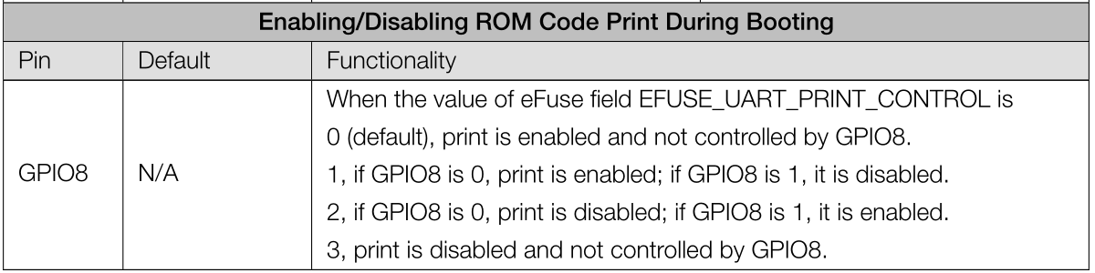

wakeup
Posts: 5
Postby wakeup » Sun Jan 05, 2025 8:23 pm
Hello again,
I built another setup on a breadboard. Can you maybe help me try the other alternative, if there is no change to do it using my way?
lbernstone
Posts: 1132
Postby lbernstone » Mon Jan 06, 2025 4:58 pm
It's not exceptionally difficult, but it involves a permanent change to your hardware. You need to burn an efuse to stop boot logging on those pins. Once that is done, just call Serial0.end() at the very top of your code, the reinitialize it with the setting you want.
Screenshot from 2025-01-06 06-44-09.png (79.91 KiB) Viewed 5287 times
wakeup
Posts: 5
Postby wakeup » Thu Jan 09, 2025 10:49 am
Thanks.
Done it.
espefuse.py --chip auto burn_efuse UART_PRINT_CONTROL 3 --port COM4
espefuse.py v4.8.dev5
Connecting...
Detecting chip type... ESP32-S3
=== Run "burn_efuse" command ===
The efuses to burn:
  from BLOCK0
     - UART_PRINT_CONTROL
Burning efuses:
    - 'UART_PRINT_CONTROL' (Set the default UART boot message output mode) 0b00 -> 0b11
Check all blocks for burn...
idx, BLOCK_NAME,          Conclusion
[00] BLOCK0               is not empty
        (written ): 0x0000000000000100000000000000d1f50000000000000000
        (to write): 0x00000000000000c000000000000000000000000000000000
        (coding scheme = NONE)
This is an irreversible operation!
Type 'BURN' (all capitals) to continue.
BURN
BURN BLOCK0  - OK (all write block bits are set)
Reading updated efuses...
Checking efuses...
Successful
