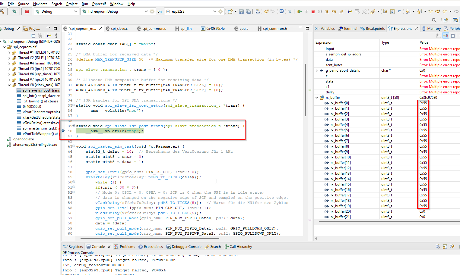

I try for some time now to design a fast parallel data transfer with an ESP32S3-WROOM1, but it seems to be a tough nut to crack with an ESP...
I need flexible bit width of 4/8-bit to link to a FPGA. Because the number of free IO's we can use for that and due to the overall limitation in available IO's, i try to set up the interface for the worst case with 4-bit. The interface should be bidirectional.
It should be possible to use the SPI in QUAD mode as slave for fast data transmission from FPGA to ESP with use of DMA.
SPI
This is what I have tried so far. Wired thing is that the interface is initialized always with only one data line. All whole receive buffer
is getting filled up with the data received in the first Data line (MOSI). All the othet lines are not represented as depicted in the "Table 30-6. Bit Order Control in GP-SPI Master and Slave Modes" on page 1096 of the ESP32S3 technical refence manual (write /read bit order when using dual/quad/octal modes).

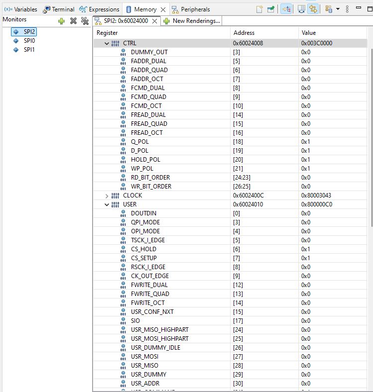

Unfortunately I cant get it to work. After performing spi_slave_initialize(), I checked the SPI2 Registers (I use SPI2 peripheral for that) and see inside SPI_CTRL_REG and SPI_USER_REG that the relevant bits are not set.
I simulate the CLK and CS signal by using another task that simulated this signals with two GPIO's. All four data lines are only "feeded" with pull-up or pull-down via software. The first pull resistor is toggeled in the task spi_master_sim_task() from high to low, generating a bit patern that can be seen in the rx data (0x55). But in my understanding not all received data should be 0x55, this is only the first data line. If the first data line is toggling and the rest of the data lines are reo it sould be something like 0x80, 0x80...
Am I making a mistake in initializing the SPI module?
Thanks very much for any suggestion on how to fix this!!
Best regards and merry Christmas!
Benedikt
This is the code I use (240Mhz, FreeRTOS 1000Hz):

arthur_koba
Joined: Mon Dec 11, 2023 2:49 pm
Re: SPI QUAD MODE
Postby arthur_koba » Thu Feb 13, 2025 11:34 am
Benedict, hello! I was also trying to try to set my ESP32 in the Master + Quad Spi mode and master + SPI_DEVICE_3WIRE mode, but unfortunately both options did not work, they worked in the standard Duplex mode. I think there is an error in the ESP SPI library... :cry:
