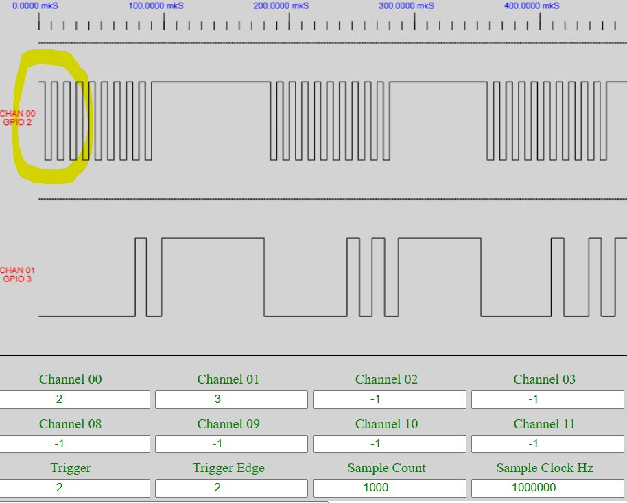

very strange
now I checked (this code is from another application)
    gpio_install_isr_service(0);                 // default
    gpio_set_intr_type(pin_trigger, trigger_edge);
    gpio_isr_handler_add(pin_trigger, la_ll_trigger_isr, (void *)pin_trigger);
    gpio_intr_disable(pin_trigger);
    gpio_intr_enable(pin_trigger); // start transfer on irq
void IRAM_ATTR la_ll_trigger_isr(void *pin)
    gpio_matrix_in(0x38, CAM_V_SYNC_IDX, false); // enable cam
    gpio_intr_disable((int)pin);
this code starts before i2c initialization (standard initialization),
no additional actions on gpio initialization are needed,
interrupt is triggered by scl, starts logic analyzer (on the same esp32s3).
scl-gpio2, sda=gpio3,pin_trigger=gpio2
