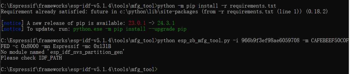

Postby mushan » Fri Jan 10, 2025 8:02 am
How can this problem be solved

Re: zigbee mfg_tool
Postby Luxni_ » Mon Jan 13, 2025 8:07 am
It should be in esp-zigbee-sdk (esp-zigbee-sdk/tools/mfg_tool/esp_zb_mfg_tool.py),
not esp-idf.
