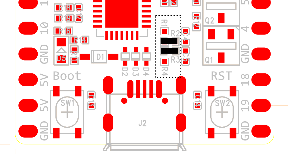

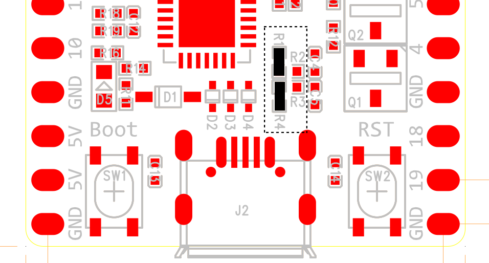

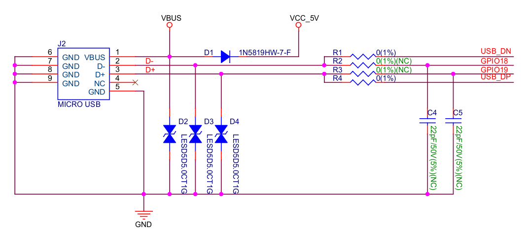

While looking at the schematic for the ESP32-C3-DevKitM-1, I noticed that the USB port on the board is not connected directly to the ESP32 module, but rather a CP2102N serial adapter.
You should be able to use the JTAG function by removing the resistors R1 and R4 on the DevKitM-1 board and move them to the position for R2 and R3.
Serial Only configuration:
USB JTAG configuration:
You may also need to populate C4 and C5 for this to work.
