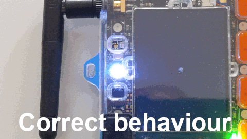

This picture shows a WS2812B LED behaving correctly. The logic is copied from the ESP-IDF/examples/get-started/blink project, and placed in a FreeRTOS task started by xTaskCreate(). There is no second task running.

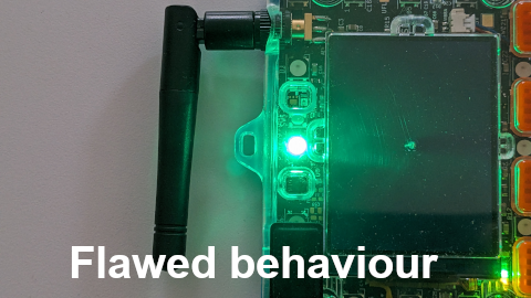

This picture shows the same device with flawed logic. The source code is the same as the first picture, however a second task is created. The second task includes the gpio_reset_pin(), gpio_set_direction(), and gpio_set_level() functions to cycle a standard LED connected to a GPIO.
The point of this excercise is to understand how to blink two leds, one standard GPIO connected and one digital WS2812 type. The two blink circuits are controlled by two FreeRTOS tasks, which should be easy.

Why is the WS2812B blink logic failing? It is a strange green colour and doesn't blink.
Suspicion
I think that the FreeRTOS scheduler is preempting the WS2812 blink logic and corrupting the signal when control is switched to other tasks.

Environment
HW: ESP32-C3
FW: ESP-IDF 5.4
The development machine (compiling using idf.py build) is a Ubuntu 24.04.1 LTS.
The version of the led_strip component used is 2.4.1 or 3.0.0, both lead to the same flaw.
HW: ESP32-C3
FW: ESP-IDF 5.4

vTaskNone() is never started in your example, if you expect to get help finding out what goes wrong, you should provide full code.
Otherwise it can only be said, that you are doing something wrong.
Best regards, Rainer

Also notice that app_main() already is a task, just one that is implicitly created by ESP-IDF rather than explicitly.
Re: xTaskCreate corrupts WS2812 LED signals
You should try to enable this in menuconfig
CONFIG_COMPILER_STACK_CHECK_MODE_ALL=y

Thanks chegewara, after setting the stack mode as you suggested I reviewed the monitor output again but nothing changed. It seems there is no problem with the task stacks.
Thanks ESP_Sprite, app_main() is indeed a task of its own. I can create a lot of tasks without corrupting the WS2812 signal, as long as the tasks do simple nonsense like just printing log messages. If I start a task that manipulates a GPIO (connected to a LED) or uses the LEDC peripheral, then the led_strip signal gets corrupted and the WS2812 fails.
Thanks IoT-Rainer, I'll upload the complete sources now, everything in the main directory. Please stay tuned.

It is highly recommended to increase tasks stack to 3500+ for tasks with logs. Even if this flag didnt catch tasks stack corruption it does not mean that task cant corrupt other part of code.
Thanks chegewara, but it did not help to dramatically increase the stack size of all the tasks:
$ idf.py flash
...causes the WS2812B (controlled by vTaskStrip) to stop blinking, freezing, and changing from its medium white to bright green. The signal is clearly corrupted (as described before) even with the larger stack size.
Do you have any more ideas that I should test?

I checked the code and it looks fine, but i recollect now i had similar issue with esp32-c6 few months ago on espressif workshops in Brno.
To be honest i dont remember what was the reason and if i solved the problem. Funny fact is that i was the only one having the issue back then.
For couple weeks i am using led_strip component on S3 mesh nodes and all works great, so it may be related to library on C3/C6 or some weird hardware problem.
Summary:
- LED init is ok
- the way you are using tasks is ok
- no obvious issue with the code
