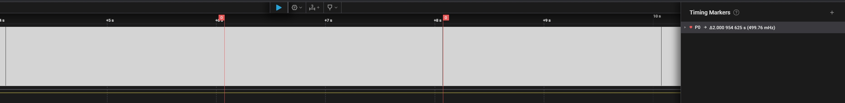

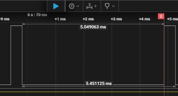

But every 2 seconds, the output freezes for roughly 5 ms, leading to stuttering in the motor movement (see logic analyzer graph).
