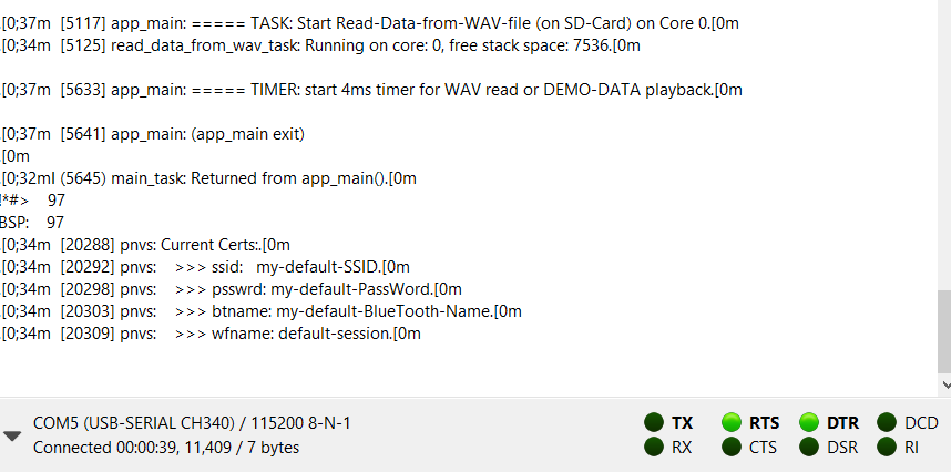

I don't use putty but I use CoolTerm all the time and it works well with the usb serial port that I run at the default 115200 as well as uart1 and uart2 ports I stream at 230400.

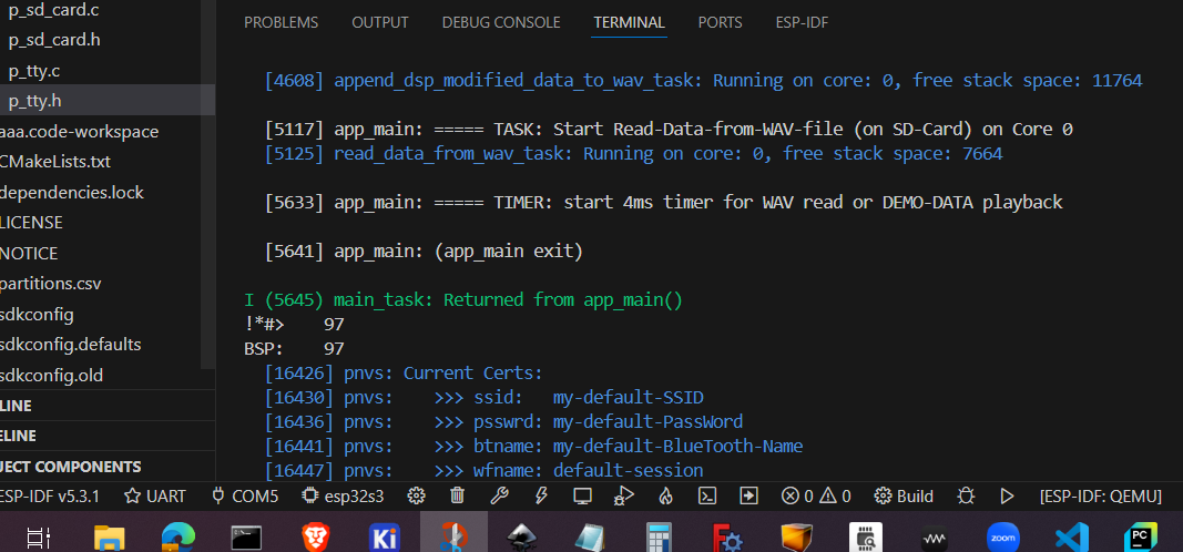

The usb connection on an esp dev board just looks like a com port to windows and it is uart0 in idf. By using the Monitor button in the ide you get the normal display -- I have a task that handles rx characters that I send to do various test things -- here I type in a little command !*#97 that dumps some info:

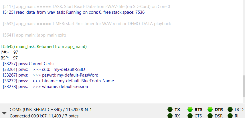

When I connect coolterm (cannot have the ide running as it holds the com port open) and connect to the same com port, I can do the same thing (here you see the ansi color prefix sequences):
Coolterm can also be configured to display in color:
