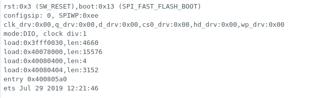

This is the a 'stock' example from the Arduino IDE using the board
DOIT ESP32 DEVKIT V1
The serial window shows the following output (again and again):
ESP32 Wifi-ScanOutput 2025-04-19T19-20-13.png (28.83 KiB) Viewed 539 times
But I don't get the information that's supposed to be provided by the sketch.
It's not even posting the messages "Setup done" and "Scan Start"
What did I do wrong here?

Probably a power issue. Do you get serial output if you just do a simple `Serial.println("Hello World");` sketch? How are you powering the device? Is this a dev board or homemade?

Yes, a simple "Hello World" sketch with an blink of the onboard LED is working fine.
Every time when I'm using a sketch with Wi-Fi is posting this block of information.
Upload is completing w/o any error.
I'm using the board "DOIT ESP32 DEV Kit V1".
I'm wondering, where is the block of information coming from? Is it returned by the board?
And what does it stands for?
Many questions. :-)

The text you are seeing is the boot log. It shows the reset reason, and then the segments it is loading from the flash for the bootloader. The system is crashing, and not giving you any backtrace. This makes me think it is not getting adequate power. Try another usb cable, try a different usb port.
