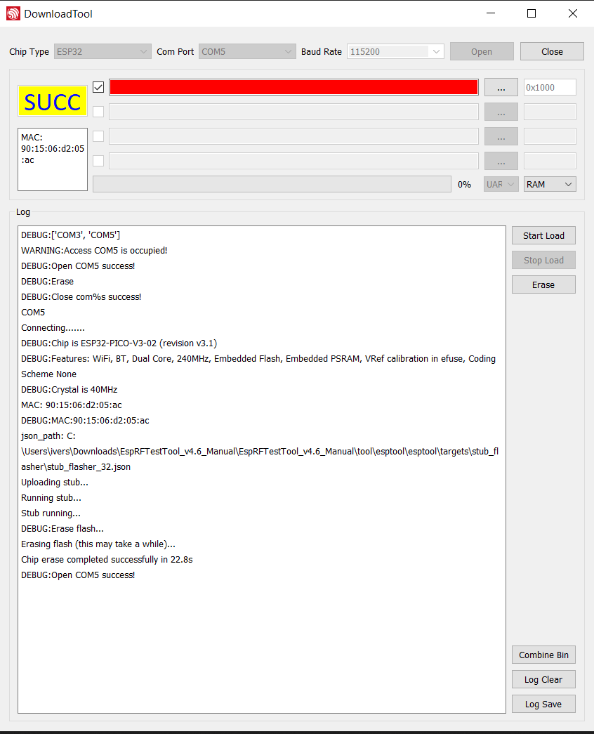

We are currently using the ESP32-PICO-MINI-02 on a custom PCB and our certification team is looking to start the preparation process for certification.
I have NOT been able to flash the provided test binaries with the EspRFTestTool v4.6 to the ESP32-PICO-MINI-02.
The test binary that I'm trying to flash is: ESP32_RFTest_V191_482eb73_20230724.bin
I have tried flashing with both the EspRFTestTool and the DownloaderTool (part of the toolkit).
Flash attempt with Downloader Tool
I have verified that I'm successfully placing the ESP32-PICO-MINI-02 into "Download Boot" mode.
rst:0x10 (RTCWDT_RTC_RESET),boot:0x3 (DOWNLOAD_BOOT(UART0/UART1/SDIO_REI_REO_V2))
waiting for download
I have tried issuing an ERASE, which completes successfully, from the DownloadTool before attempting to flash.
Issuing an Erase
I have tried updating the flash address from the default 0x1000 to 0x8000 (this was from a post on the ESP32 forum).
I know the communication is working as I AM able to load the test binary into RAM (test commands appear to work as well), but giving out device and test we wish to run, it is highly desirable to run the test binary out of flash.

I am currently using the esptool.py to issue a chip erase:
esptool.py -p <YOUR-ESP32-UART0-PORT> -b 460800 --after hard_reset --chip esp32 erase_flash
Then programming the RF Test Binary to the address the bootloader is normally flashed to:
esptool.py -p <YOUR-ESP32-UART0-PORT> -b 460800 --after hard_reset --chip esp32 write_flash  --flash_mode dio --flash_freq 40m --flash_size
With this I am able to run commands using the RFEspRFTestTool (v4.6), but I'm not able to use the "Certification EN" checkbox as it tries to load the power level table to the ESP32's flash. The underlying issue is the RFEspRFTestTool needs to be updated with the flash parameters required for the ESP32-PIC-MIN-02 (ESP32-PICO-V3-02 v3.1).

With help from espressif FAE, I was able to get this to work.
1. Use the power limit tool in EspRFTestTool (v4.6) to generate the appropriate phy_init.bin file.
2. Use Espressif Flash Download Tool (v3..9.8) to download the appropriate RFTest.bin and associated phy_init.bin files. As you pointed out, using EspRFTestTool (v4.6) to download to flash doesn't work.
3. Use EspRFTestTool (v3.6) instead of v4.6 to run the actual tests, including turning "Certification EN" to ON.
Hope this helps!
