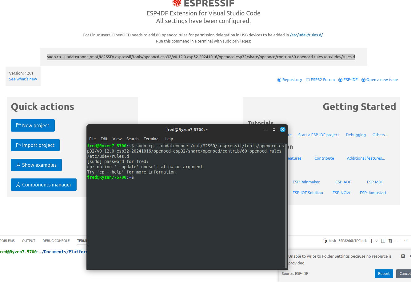

I just tried to install the ESP-IDF extension in vscode (Linux Mint v21.3).
At the end of the process it's asking me to copy the file [60-openocd.rules] with the command
sudo cp –update=none
 /mnt/M2SSD/.espressif/tools/openocd-esp32/v0.12.0-esp32-20241016/openocd-esp32/share/openocd/contrib/60-openocd.rules /etc/udev/rules.d
However, when executing the command it declines the execution with the message [CP: option '--update' doesn't allow an argument].
See attached screenshot.
How should I proceed?
Thanks
ESP-IDF screenshot
ESP-IDF Screenshot 2025-04-24T07-32-30.png (130.32 KiB) Viewed 550 times

cp command does not have the option --update=none.
man cp or cp --help will show all options.
$ LANG=C cp --help
