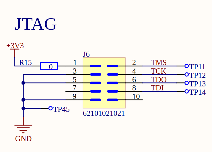

I have an ESP32-S3-WROOM-1-N8R2 on a custom board with a JTAG connector.
The JTAG connection is the following to the chip:
I am trying to flash and debug code with an ESP-Prog.
In the ESP-IDF configurations, I am creating the basic "hello world" project, where in "Choose ESP-IDF Board" I select ESP32-S3 (via ESP-PROG). I have done no extra configurations in the SDK Configuration editor, and all settings are the default ones. The pin header for selecting the power supply on the ESP-Prog is set to 3.3V.
When I flash the code, I have the following output:

adapter speed: 20000 kHz
Info : ftdi: if you experience problems at higher adapter clocks, try the command "ftdi tdo_sample_edge falling"
Info : clock speed 20000 kHz
Info : JTAG tap: esp32s3.tap0 tap/device found: 0x120034e5 (mfg: 0x272 (Tensilica), part: 0x2003, ver: 0x1)
Info : JTAG tap: esp32s3.tap1 tap/device found: 0x120034e5 (mfg: 0x272 (Tensilica), part: 0x2003, ver: 0x1)
Info : [esp32s3.cpu0] Examination succeed
❌ Warn : [esp32s3.cpu1] Unexpected OCD_ID = 00000000
Error: [esp32s3.cpu1] Examination failed
Warn : target esp32s3.cpu1 examination failed

Also when I start debugging with a breakpoint I get the following output:
Info : [esp32s3.cpu0] Target halted, PC=0x400454D5, debug_reason=00000000
Info : [esp32s3.cpu1] Target halted, PC=0x40043A40, debug_reason=00000000
Info : [esp32s3.cpu0] Target halted, PC=0x4038CCA2, debug_reason=00000001
Warn : Empty flash mapping!
Warn : Failed to get flash mappings (0)!
Info : Using flash bank 'esp32s3.cpu0.irom' size 0 KB
Info : Using flash bank 'esp32s3.cpu0.drom' size 0 KB
Info : New GDB Connection: 1, Target esp32s3.cpu0, state: halted
Info : [esp32s3.cpu0] requesting target halt and executing a soft reset
Info : [esp32s3.cpu0] Debug controller was reset.
Info : [esp32s3.cpu0] Core was reset.
Info : [esp32s3.cpu0] Target halted, PC=0x500000EF, debug_reason=00000000
❌ Info : [esp32s3.cpu0] Reset cause (3) - (Software core reset)
Warn : address 0x3ffb244c not writable
Error: Failed to clear uxCurrentNumberOfTasks!
Warn : Failed to do rtos-specific cleanup (-4)
Info : [esp32s3.cpu1] Debug controller was reset.
Info : [esp32s3.cpu1] Core was reset.
Info : [esp32s3.cpu1] Target halted, PC=0x500000EF, debug_reason=00000000
Info : [esp32s3.cpu1] Reset cause (3) - (Software core reset)
❌ Error: [esp32s3.cpu0] Failed to read original instruction (-4)!
Error: [esp32s3.cpu0] Failed to add SW breakpoint!
Error: [esp32s3.cpu0] can't add breakpoint: unknown reason
[/OpenOCD]
[SDK Configuration Editor]
Executing action: confserver
Running cmake in directory /home/svetoslav/project-name/build
Executing "cmake -G Ninja -DPYTHON_DEPS_CHECKED=1 -DPYTHON=/home/svetoslav/.espressif/python_env/idf5.5_py3.10_env/bin/python -DESP_PLATFORM=1 -DSDKCONFIG=/home/svetoslav/project-name/sdkconfig -DCCACHE_ENABLE=0 /home/svetoslav/project-name"...
-- Minimal build - ON
-- git rev-parse returned 'fatal: not a git repository (or any of the parent directories): .git'
-- Could not use 'git describe' to determine PROJECT_VER.
-- Building ESP-IDF components for target esp32
The debugging starts, but if a breakpoint is put, it doesn't work. If I try to pause or restart the code through VS Code, I get the following:
[OpenOCD]
Info : The target is not running when halt was requested, stopping GDB.
Info : dropped 'gdb' connection
[Stopped] : OpenOCD Server
A lot of the time, after flashing one or two times, OpenOCD starts giving me errors that the device is not detected, and I cannot flash, debug or anything until I restart VS Code, disconnect the board and the device.
Also, after flashing the code and trying to open the serial monitor to see the "Hello World", nothing shows up. Even after a reset of the device, I get nothing on the serial monitor.
I am not sure why I am getting the warnings and errors in the beginning when flashing as well. Does anyone have an idea what could be causing this?
Does anyone know what the issue could be with this? Is there something extra that I need to put as configurations for this board? Or something hardware related to the JTAG interface?
Posts: 10650
Re: ESP32-S3-WROOM-1 ESP PROG flash/debug issues
Postby Sprite » Wed Apr 30, 2025 1:45 am
JTAG fails to connect; the rest of the messages are just a result of that. The reason is that by default, the ESP32S3 uses JTAG over the built-in USB-serial-JTAG converter. You will need to connect over that or UART to blow an e-fuse if you want to use 'classic' 4-pin JTAG.
