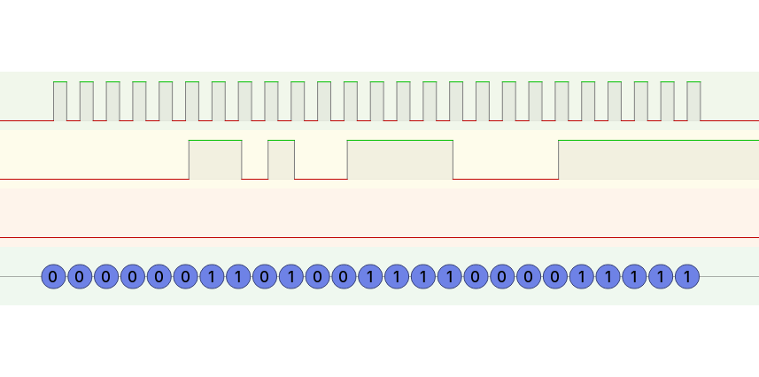

I need to decode custom protocol in non-blocking mode. The data looks like this:
With RMT I can receive symbols with level and duration.
I can restore value by some calculations, but it will be better to get proper chunks directly from hardware like this:
{1 high, 0 low}
{1 high, 0 low}
{1 high, 0 low}
{0 high, 1 low}
{1 high, 0 low}
{0 high, 1 low}
{0 high, 1 low}
I thought I could use signal_range_max_ns from rmt_receive_config_t, but no luck:
rmt_receive_config_t::signal_range_max_ns specifies the maximum valid pulse duration in either high or low logic levels. A pulse width that is bigger than this value is treated as Stop Signal, and the receiver generates receive-complete event immediately.
No, I cant, because If there will be multiple high level bits at the end of word, rmt won't calculate them because there is no falling edge after last bit... You can assume that there is high level bits if rmt symbols not enough. But it looks like a bad hack.

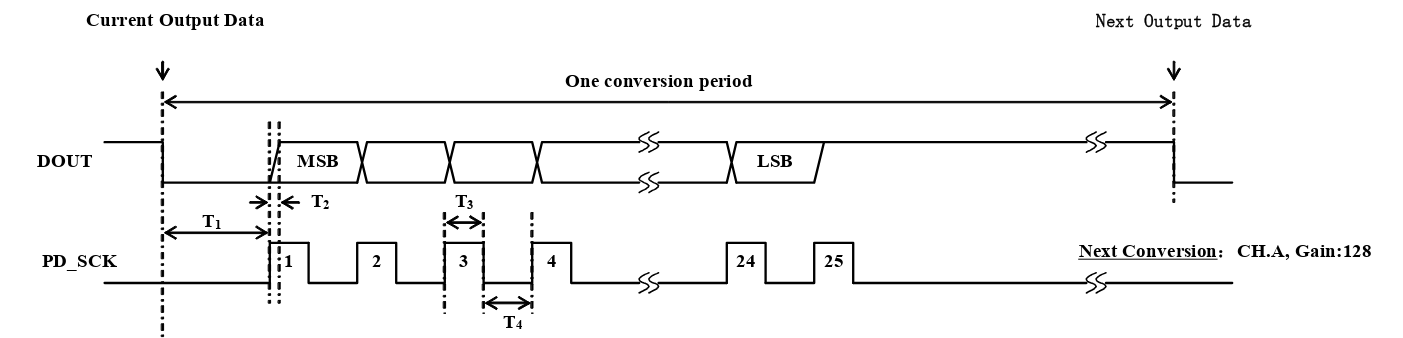

Yes, I'm sending the clock signal. It's HX711 ADC (datasheet) ADC and I need to read different channels of couple ACDS in non blocking mode.

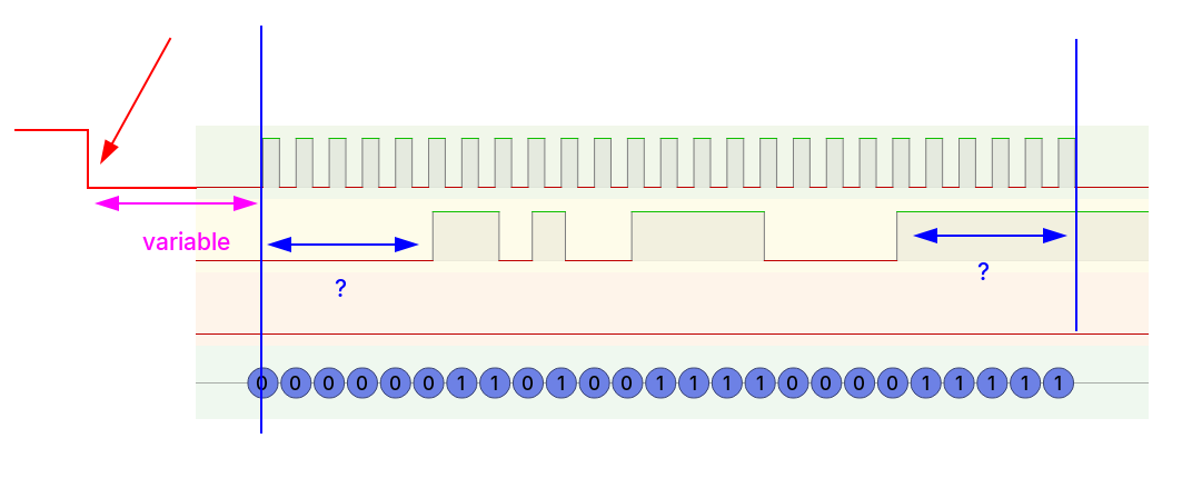

Thank you for answer. ~5.4 micro-seconds of blocked core - it's ideal value for single cell and high-end rates cpu/adc datarate possibilities, recommended speed from datasheet is 1µs for single bit - its reasonable to make system reliable.
But. I found that RMT totally unuseable in this case:
RMT impossible signal.png (21.12 KiB) Viewed 168 times
We don't know how many LOW level bits were skipped at start and how many HI level bits will be in the end..
MicroController
Posts: 2705
Location: Europe, Germany
Re: Could RMT split "rmt_symbols" by time, not by level change?
Postby MicroController » Fri May 09, 2025 10:44 am
It seems the RMT could still be used. The RMT should detect the 'asynchronous' falling edge of DOUT, then you send 25-27 clock pulses, then stop the RMT. You can calculate the bits 'backwards' in time, starting from the final falling edge of PD_SCK.
But using SPI is probably still easier.
imShara
Posts: 10
Joined: Wed Feb 19, 2020 2:00 pm
Postby imShara » Fri May 09, 2025 1:23 pm
Hmm.. I'm using interruption, but ok RMT could detect DOUT low as [HI=0 LO=0], but what should it gave? Time between DOUT turns low and SCK starts transmission is variable.
RMT impossible signal2.png (27.62 KiB) Viewed 155 times
Thre is only 2 SPI channels and 8 (could be 1TX 7RX) RMT
i2s can't be used too - it starts clocking before receive is strarted.
