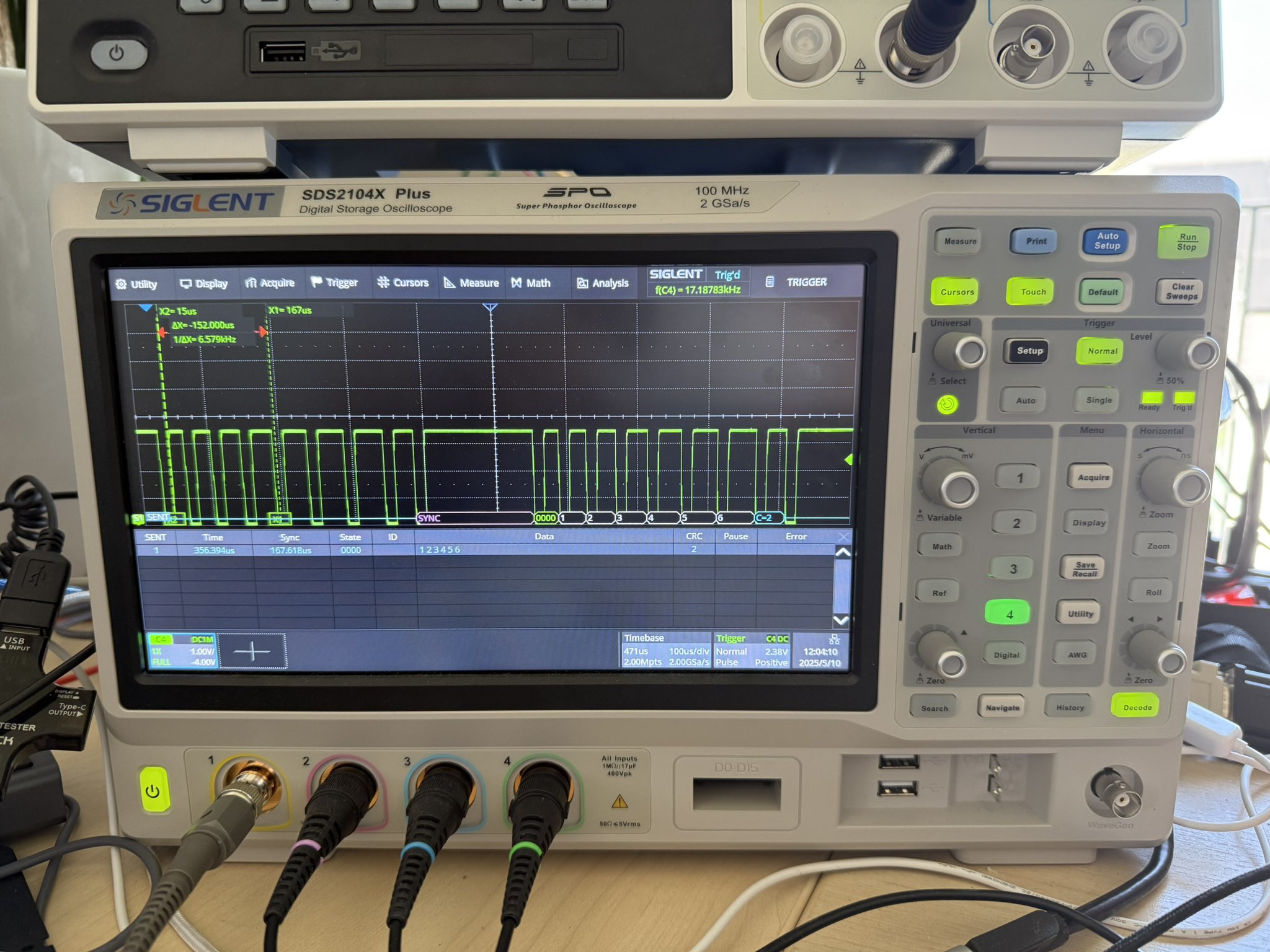

I'm implementing transmitters and receivers for the SENT (SAE J2716) protocol, a tick-based protocol (default tick length 3µs), which transmits a SYNC pulse (length 56 ticks), then 6 + 2 nibbles based pulses with different lengths (12 + nibble-value). Here's an example from my scope:
Sending this using RMT is straightforward and works very well.
Receiving though seems to be more complicated. Note that I do my decoding decoupled from the rx callback
and have the callback marked w/ IRAM_ATTR.
Here's portions from my code so you can see how I'm initializing RMT:

My concrete example (as seen on the scope) is using a 3µs tick time. SENT pulse lengths are always measured from falling edge to falling edge.

The problem: I can't seem to set the parameters correctly to receive SYNC pulses. SYNC pulses are supposed to have a length of 168µs, but when I try to configure it like that:
        auto config = rmt_receive_config_t {
            .signal_range_min_ns = 1 * 1000,     // 1µs resolution
            .signal_range_max_ns = 175 * 1000,   // Max sync high pulse
Then nothing works anymore and I'm just getting a loop full of:
E rmt: user buffer too small, received symbols truncated
Now: Limiting signal_range_max_ns to 100 * 1000 seems to work somewhat, at least I can see the data nibbles being correctly deciphered. But then I can't no longer read the 168µs SYNC pulse and instead I'm getting spurious symbols with length 0. If you see compare the log output, you'll see that I frequently get those "in the middle" of the correctly detected symbols. Since I can rule out the sender doing strange things, the receiver must be the problem.
What is happening here? Why is the signal_range_max_ns not allowing 175 and why am I getting 0 lengths (followed by symbols where the polarity is switched, e.g. level0 is HIGH and level1 is LOW whereas they're typically vice versa).

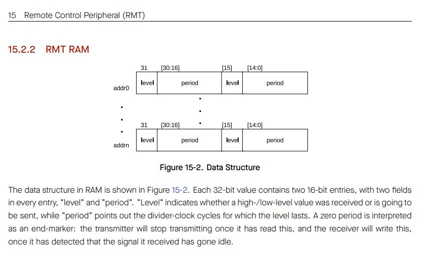

And just after looking for 2 days without a clue, but then formulating the question, I stumbled over the .en_partial_rx flag.
Enabling this did the trick and I'm now a) getting my SYNC pulses and b) no longer spurious 0 lengths:

If the interval is exceeded - rmt gives interval length = 0, sign of end of reception
That's the secret sauce. Did I really overlook that in the documentation?
ok-home
Posts: 157
Location: Russia Novosibirsk
Contact:
Re: RMT receiving oddities
Postby ok-home » Mon May 12, 2025 1:04 am
This is hidden a little deeper in the documentation ))
https://www.espressif.com/sites/default/files/documentation/esp32_technical_reference_manual_en.pdf
Esp32 trm p414 rmt.JPG (58.2 KiB) Viewed 176 times
