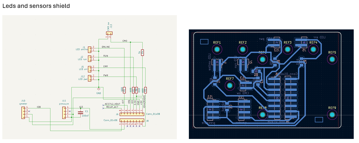

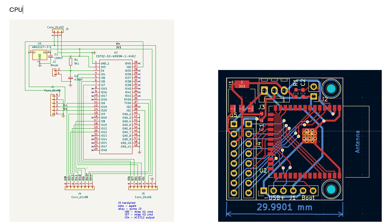

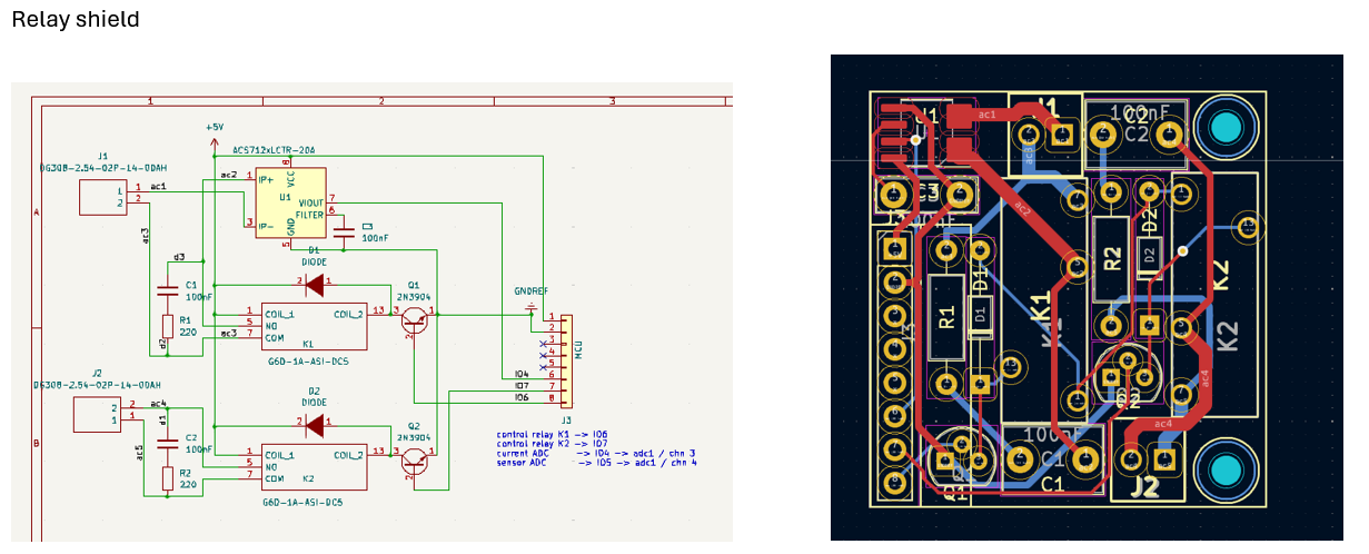

Here they are
Thera are 3 shields mounted in a sandwich.
From bottom to top: 1 - relay shield, 2 - cpu, 3 - leds and sensors shield
On the relay shield board only 1 relay is populated
the floating wire i'm talking about is soldered to J2 Reset - pin 2
Hope the resolution is good enough to get the needed details
cpu
Screenshot 2025-05-13 091440.png (351.07 KiB) Viewed 191 times
relay shield
Screenshot 2025-05-13 091510.png (281.16 KiB) Viewed 191 times
Screenshot 2025-05-13 091602.png (245.81 KiB) Viewed 191 times

I'm not seeing much bulk decoupling capacitance - 3x100nf at some ics and that's about it. I'd put some large-ish (say 22uF to 100uF) capacitors between 3.3V and ground and 5V and ground. Not having much decoupling can be an issue as you're switching inductive loads, namely the relay coils.

+5V already has 2x100uF caps. 1 on the power board and 1 on the sensors shield (not shown in the schematics, because i added it later to reduce the noise at the ADC level). Will place another 100uF on 3.3V and let you know if any improvment.
Anyway the issue happens no matter the relay is switched or not.

Do you normally have anything connected to j2?

Postby ves011 » Wed May 14, 2025 5:32 am
No, nothing connected. Just a 2 pin header, the same like IO0, just in case i need to plug a switch.
Yesterday i tested it "in production" with the pump and sensors connected and all good but with the floating wire connected.
Its amazing and puzzling how that bloody wire does the trick!?!?!?!
