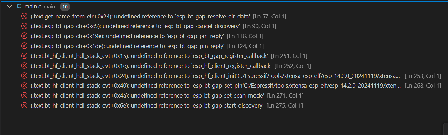

I'm installing fresh off GIT to Linux ESP-IDF and then trying to compile the IDF provided classic bluetooth hpf_hf example for ESP32-s2/s3 and the build process fails.
SO I guess the question is - if "Classic Bluetooth" isn't supported on the S3 (and the hardware matrix says that) -- the docs read like classic bluetooth is somehow maybe provided through BlueDroid. But the hpf_hf readme says the example is for ESP32 (not S3).
OK -- so why is Espressif designing audio (video) gizmos like the Korvo2 when none of the example applications that do audio/video can compile?
I'm building the example pipeline_a2dp_sink_and_hfp ESP_ADF project with a brand new KORVO2 Audio development board.
I've read the readme.md and set the product according to the instructions.
When I create the project using the ESP_ADF examples, I get this compile error:

After tinkering some more - I've installed v5.3.3 and v5.4.1 of the ESP-IDF.
If I try to compile the more basic bluetooth (using BlueDroid as included) HF example (in the examples lists) and under each version of IDF, none of them compile.
if feels like something is missing from VScode in terms of plugins -- or the ESP VScode plugin is forgetting to do something.
5.4.1 almost compiles - but I get this:
I don't know what I'm missing.
-Ben

OK - I installed the ESP-IDF (v5.4.1) for CLI building from scratch in a Mint Linux VM using the ESP-IDF instructions.
https://docs.espressif.com/projects/esp ... setup.html
That part's easy -- so then I went to compile the hfp_hf example and it fails the same way as VScode does (but all the from bash commandline)
So definitely the instructions are lacking some form of setup.
(I can't even get the esp-adf to do an initial 'idf.py set-target esp32s3' as needed for my korvo2 development board - but let's start here.)
So attached is the build log.

Ok - now I installed ESP-IDF 5.3.3 -- and used the same example (hpf_hf) that comes with it in the examples folder and it fails as well.
(attached is the compile log)
These are examples compiled as "out of the box" as possible and none of them work.
So something is definitely wrong with the setup, the instructions or the example.
esp32s3.hpf_hf.example-v5.3.3-idf_py_stdout_output_11066.log
(201.86 KiB) Downloaded 8 times
The ESP32-S2/S3 don't support Bluetooth "Classic", only the original ESP32 does. You won't get classic Bluetooth support to compile for ESP32-Sx, and it will definitely not run.
(The "Supported Targets - ESP32" at the top of the README also kind-of gives it away...)
