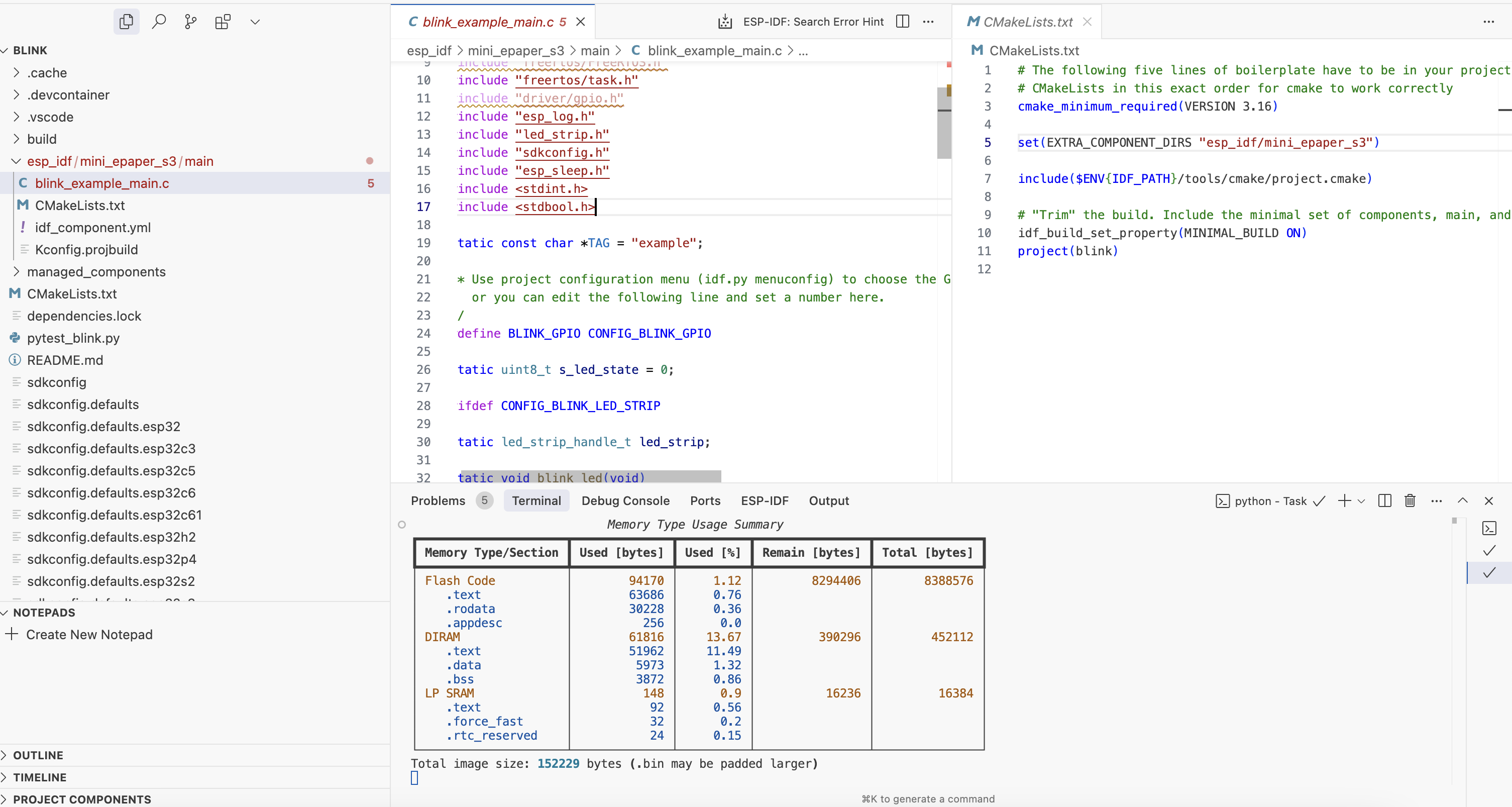

Postby kondalkolipaka » Fri May 23, 2025 12:47 pm
Could you replace add_subdirectory(esp_idf/mini_epaper_s3) with the set(EXTRA_COMPONENT_DIRS "esp_idf/mini_epaper_s3") see if that helps?
More on this here - https://docs.espressif.com/projects/esp ... -component

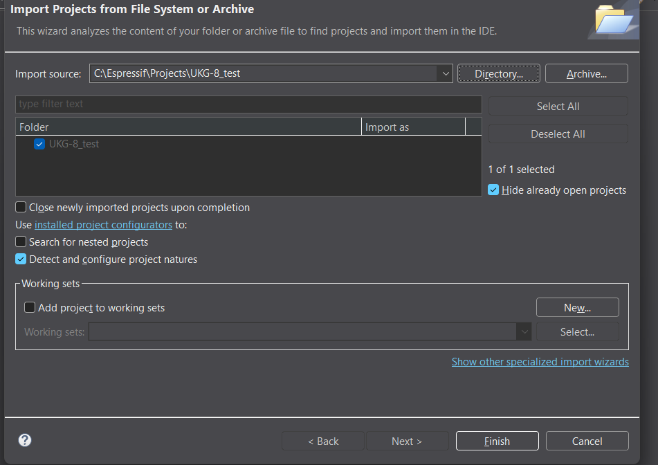

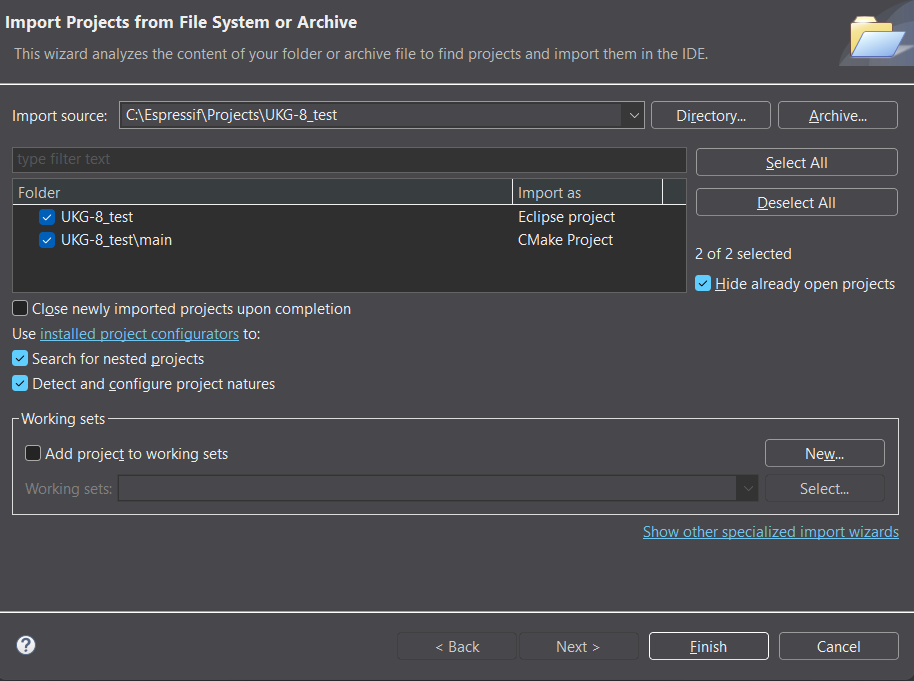

mikl604
Posts: 44
Joined: Thu Aug 24, 2023 3:15 pm
Re: Cannot find IDF_PATH/components
Postby mikl604 » Mon May 26, 2025 8:20 am
I found such a bug (or feature) :)
If you upload a project with the "Search for nested projects" field marked, then a bunch of errors about undiscovered libraries appear. And if you download with the "Search for nested projects" unchecked, then everything compiles normally.
