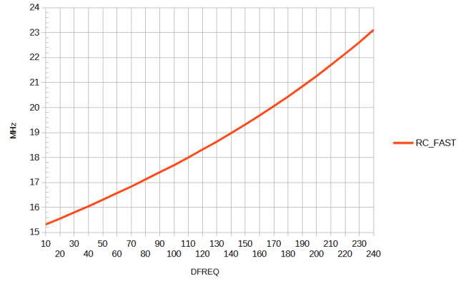

Postby MicroController » Sun May 25, 2025 10:58 pm
Had to give it a try...
I seem to be able to 'pull' the RC_FAST_CLK all the way from ~15 to ~23MHz. Impressive!
ESP32-S3 RC FAST trim small.png (27.14 KiB) Viewed 88 times
(~23.6kHz/DFREQ at the low end, ~50.3kHz/DFREQ at the high end)
