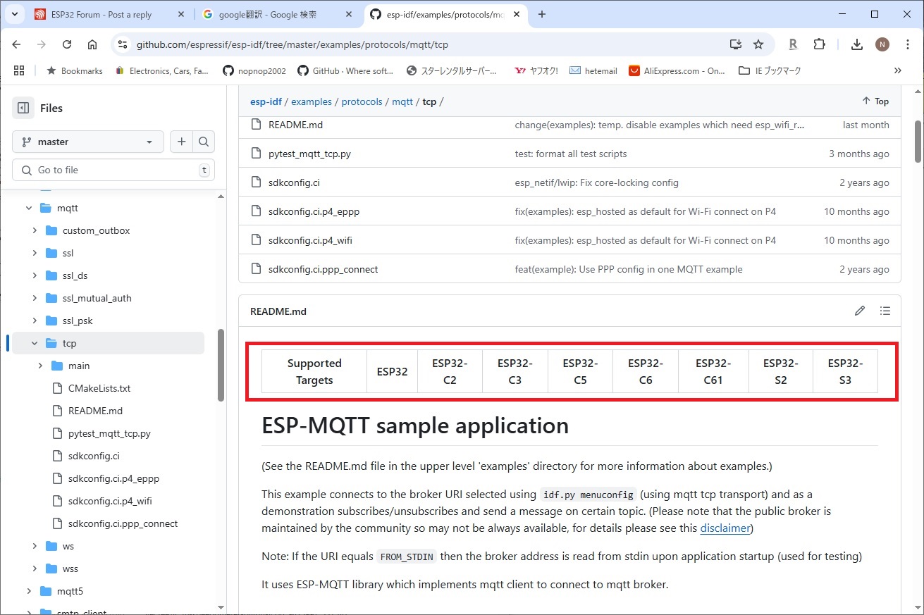

I am using esp-idf version 5.4.1. i am using esp32-p4 board. I wanted to test mqtt example on esp32-p4. I am getting error "esp_mqtt_demo: connect to the AP fail" when i run mqtt example. Attached the log file. Please help.

The sample you are using may not support ESP32P4.
Please check the supported targets.
