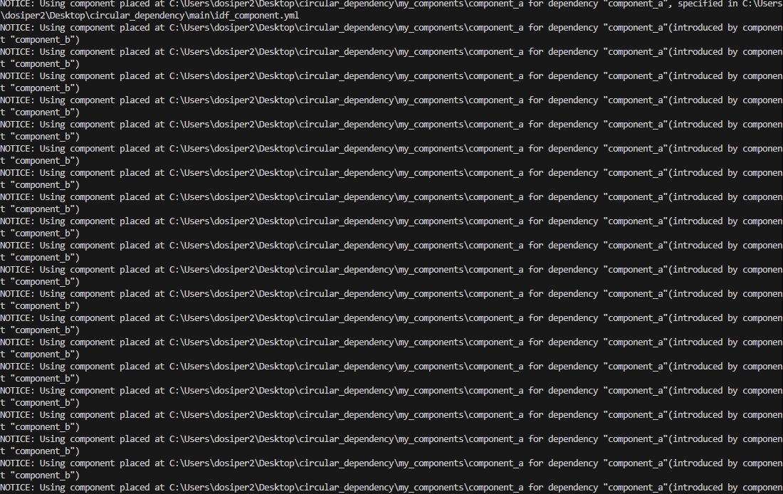

I am trying to understand how IDF Component Manager deals with circular dependencies.
I have 2 components: "component_a" and "component_b" and they depend on each other

Ok so now I create a new project and from this one I just want to use "component_a" so idf_component.yml inside the new project looks like this:
dependencies:
  component_a:
    path: ../my_components/component_a
And the source file just calls a function from "component_a" like this:
#include <stdio.h>
#include "component_a.h"
void app_main(void)
    funcA();
    printf("Circular dependency example completed.\n");
If I compile it like this, then IDF Component Manager enters into a circular dependency loop and fails:
2025-06-05 12 51 19.png (76.34 KiB) Viewed 196 times
The only way I can see to solve this is removing the dependencies of "component_a" and "component_b" and handle all the required dependencies in the main project.
This doesn't seem to be the perfect solution because this way I need to know all the dependencies needed by every component used, even components that I don't want to use directly in the main project (like component_b in this example)
Shouldn't the IDF Component Manager be able to handle this circular dependencies issue? Am I missing something here?

Hi @ok-home,
I had already looked into that property but that seems related to a later step. I am not getting a linker error but a dependency download loop.

I still get the same circular dependency loop. I have also ensured the property has been propertly set by modifying the dependencies to make it run correctly so I can see the message "link_interface is: 5" in the console.
As I said I think the loop I am experimenting is previous to this configuration file. For example, even Iif I completely DELETE the contents of this file (wrong contents for sure), I still get the same infinite loop, like if this file is not processed until a later step.

Hi all,
It seemed to be a bug, I posted it on GitHub and it's fixed now, just waiting for the new release: https://github.com/espressif/idf-compon ... 8076393530

Postby rocotocloc » Fri Jun 13, 2025 5:15 am
It's been fixed in release 2.2.2 of Component Manager: https://github.com/espressif/idf-compon ... r/releases
Run this to update in case you're interested:
python -m pip install --upgrade idf-component-manager
