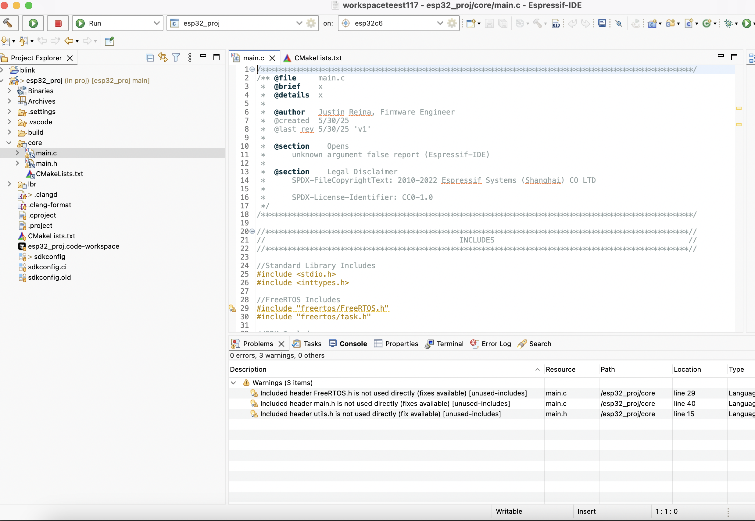

I am now getting drv_unknown_argument errors for my recent project builds -
Unexpected Problems:
Example Problems.png (65.18 KiB) Viewed 923 times
What is this, can it be removed? Here is the example project which displays this (see test\ in this proj for detail) -
Here is the config for that demo

Looks like .clangd configuration file is missing in your project with the below settings. Could you please check?
CompileFlags:
  CompilationDatabase: build
  Remove: [-m*, -f*]

Ok, imported your project and recompiled and I could reproduce the problem!
> set(EXTRA_COMPONENT_DIRS ${CMAKE_CURRENT_LIST_DIR}/../core)
Since you’ve configured core as an external component, clangd expects every external component to have its own .clangd file to avoid these errors. This is a limitation of clangd, and we hope it will eventually handle this recursively for all components added to the project.
For now, you can resolve the issue by adding a .clangd file inside your core component. For example, here’s the .clangd configuration I used in the core component, which resolved the errors:
CompileFlags:
  Remove: [-m*, -f*]
Screenshot 2025-06-06 at 7.44.50 AM.png (1.42 MiB) Viewed 912 times
I hope that helps!
