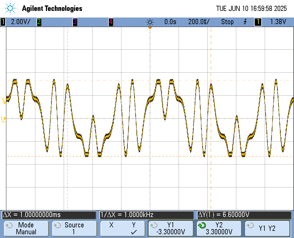

I am trying to output a 1kHz sine wave to an attached I2S DAC (PCM5102A).
I generate one cycle in memory (sampled at 32 points) and output the buffer continually. The sample rate is set to 32 KHz / 32 bit per channel. I have presumed that I had to convert from little endian (as calculated by the ESP32) to big endian for the I2S transport.
I've tried various combinations and settings without success.
What I end up with is a complex waveform with higher frequencies than 1kHz (but the filters in the DAC are probably hiding what is really generated).
The bck clock looks like it is the correct phase (checking the PCM5102A data sheet).
A stripped down Espressif sample code was used (see below).
If anyone has seen this before and knows a solution or suggestion please let me know !
Michael

Apparently, although I2S is big endian and the ESP32 little endian, no conversion is needed.
I guess
i2s_channel_write()
assumes that a conversion is needed.
Michael

CYCLES_PER_BUFFER is 16 (so, 16ms worth) yet you have a delay of 200millis in your loop?
If the last param to i2c_write_channel is TickTypes_t then you don't even need the delay, surely that'll block till there's space to write that chunk?
Your scope capture -- at least where it looks like a sine wave -- looks like f=2.0-2.2kHz so there's possibly a mismatch in the datarate configured in ESP-IDF vs datarate configured in your DAC.
It looks like you're loading L+R channels into the buffer, I'd suggest loading L channel as something like 0x55555555 and R channel as 0xFFFF0000 and you should very clearly see on the i2s DOUT line that you have the correct timing and phase: 0x55555555 should align with LRCLK high and 0xFFFF0000 should align with LRCLK low, and L channel should be half BCLK.
You can also check endianness by sending 0x55550F0F or similar, and should see MSB toggling (0x5555) higher rate than LSB (x0F0F) within the LRCLK edges for that channel. Double-check against "9.3.2.2 PCM Audio Data Formats" of the datasheet, and you configuration of the DAC's "FMT" pin, to determine if the generated I2S is correct.
Notice that the screen is at 200us/div, so more like ~10kHz.
The wave form actually resembles what you get when the byte order is wrong. Should be trivial to test...
