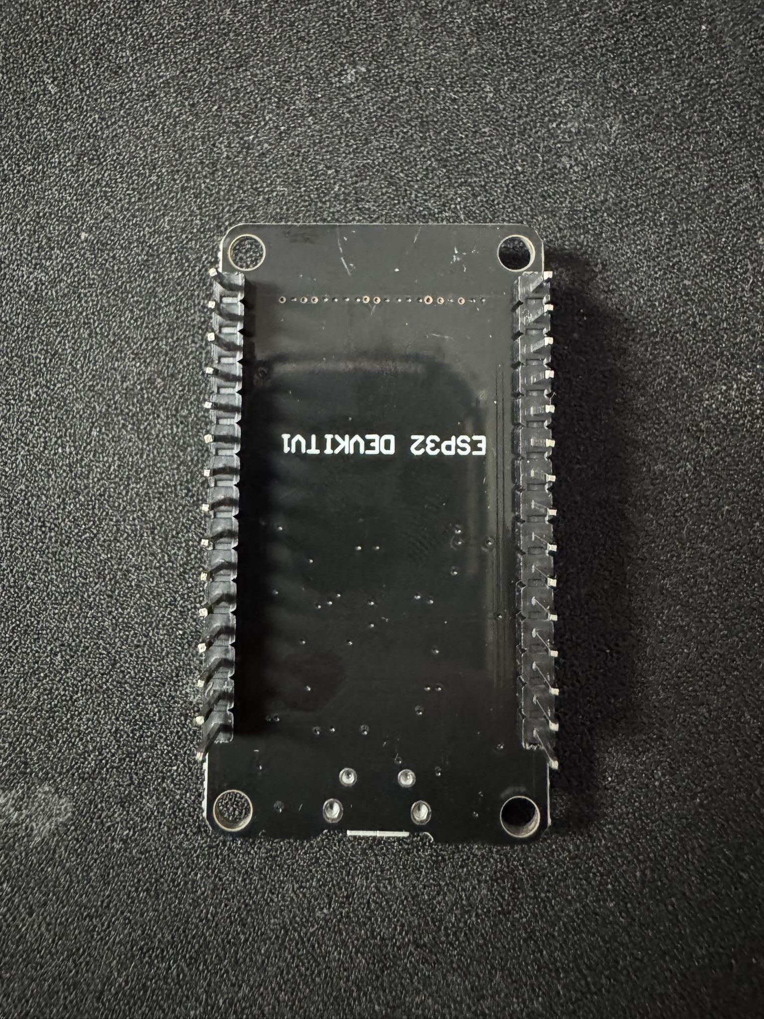

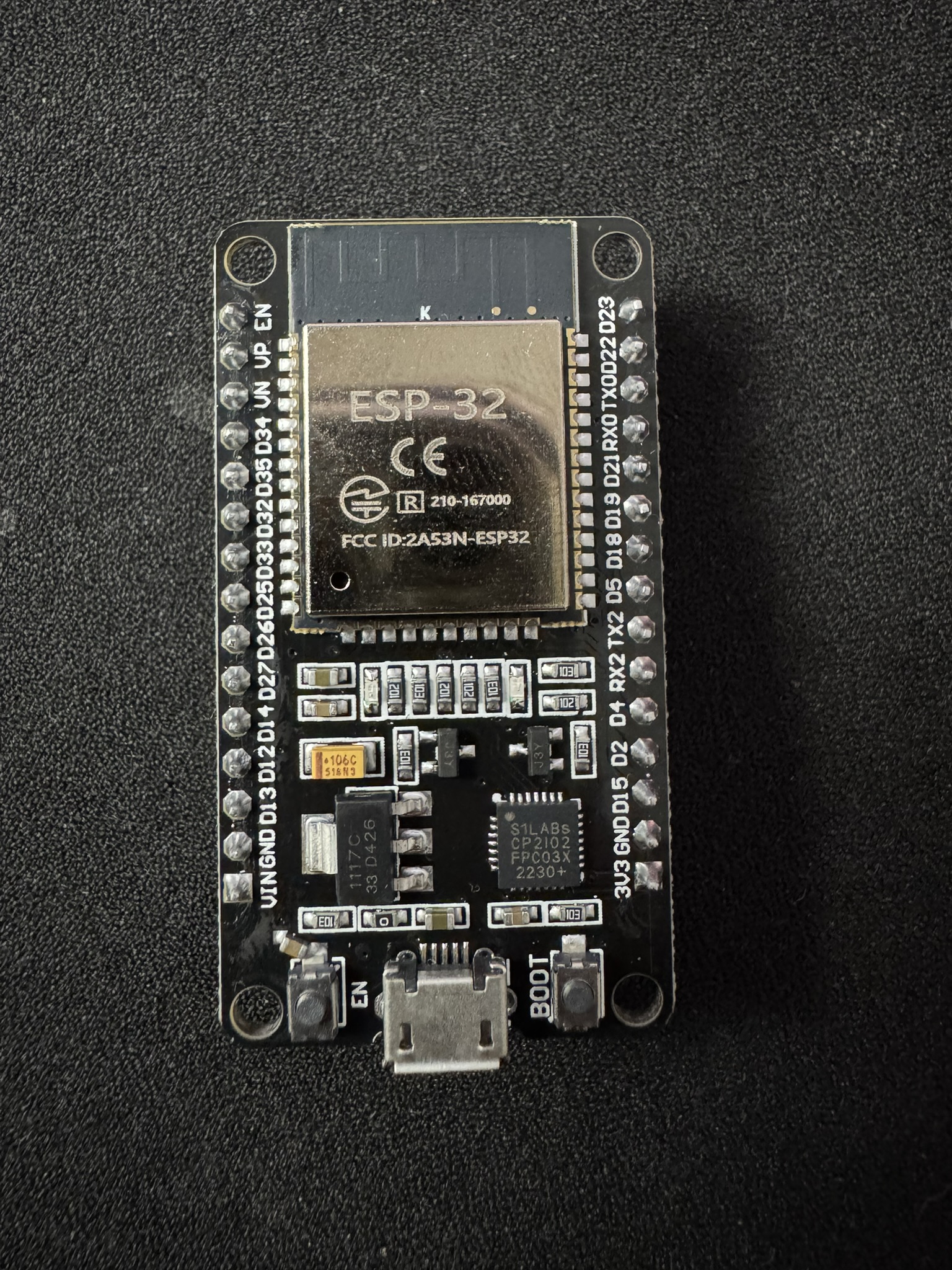

I have bought ESP32 DevKit V1 board, but I cannot find any specific documentation dedicated for this exact development board.
Some of files that are called as DevKit V1 documentation have this board with 5V supply pin, when in reality there is not such a connection. I am so confused that I have to ask you to clarify if I read schematics in a bad way or there is documentation written for this board, but I couldn't find it.
Can you please provide me with a pinout schematic (numbers and type of transmition) for this particular thing?

Looks like a no-name generic development board; it certainly is not made by Espressif as it doesn't have our logos anywhere. Looks like you can glance most of the info you'd need from the PCB itself: it uses an AMS1117(-clone) for the 3.3V, a CP2102(-clone) for the serial connection, and all the GPIOs are labeled and brought out to the headers. Is there anything more you'd want to know?
