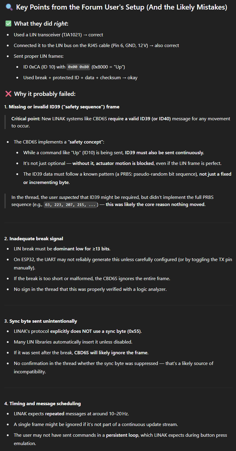

Janphr88
Joined: Thu Jul 17, 2025 11:19 am
Re: [HELP] Looking for help with challenging ESP32 + LINAK CBD6S LIN bus project - would appreciate any assistance!
Postby Janphr88 » Thu Jul 17, 2025 11:48 am
Hey!
I'll be trying to do something similar starting next week, once the first CBD6S has arrived. I've already done some research in preparation (i.e. I asked ChatGPT).
The screenshot shows its response to your attempt.
First thing I will try is:
Minimal Working Arduino Sketch
Arduino Mega + TJA1021 (or MCP2004) transceiver, sending both ID10 Up and ID39 safety PRBS, at 10 Hz, no sync byte:

Hope it helps and I'll join testing next week :)
Screenshot 2025-07-17 134205.png (130.73 KiB) Viewed 451 times
