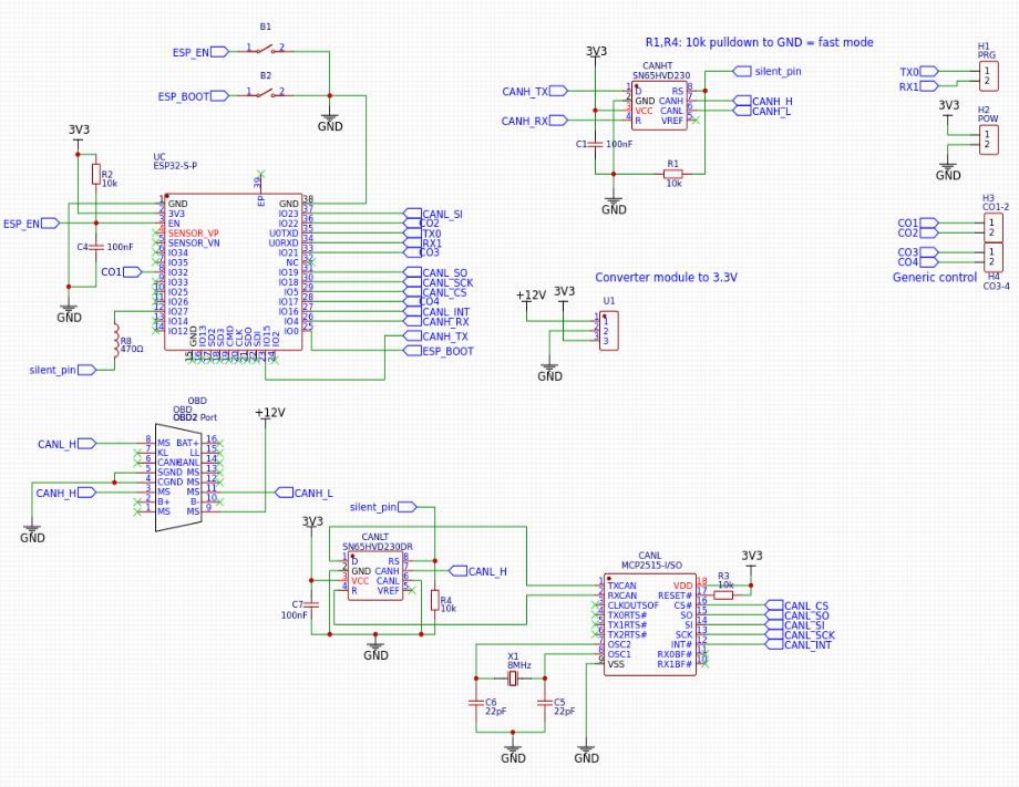

Hello All,
I designed a board to use 2 can buses with ESP32-D0WDQ6-V3 (revision v3.0). One of the can buses use the builtin TJA1000 + SN65HVD230 chip (this post is not about that part) and the other uses an MCP2515 + SN65HVD230. The reason for this (maybe unusual) setup is that I could have only one voltage rail (3.3V) as all components work with that. The wiring diagram looks like this:
As I'm a bit more familiar to TJA1000, I started working on the other part. I use Cory J Fowler's mcp_can library that work excellent with my old Arduino projects. The first part went pretty well, I can see the messages of the CAN bus. The problem is that I cannot send messages, the TX part does not work at all.

As you can see, I don't even include other libraries to prevent any collision.
Since the mcp_can library works for people, I'm suspecting a hardware design failure. Especially the slope control; I verified that the Rs pin is pulled down to GND, in the code I set GPIO27 to low. The connectivity of all other pins are OK and Vcc and GND has the correct voltage levels.
The SendMsgBuf() returns back with 7 (CAN_SENDMSGTIMEOUT) a couple of times, then 6 (CAN_GETTXBFTIMEOUT) as the outbut buffer expires.
I removed R8 so the Rs pins must be on GND level, but nothing changed.
How come that the RX works and TX not? I only designed boards with two voltage rails (3.3V for micro and 5V for CAN) so far, but jumping between the voltage levels was always inconvenient, I thought 3.3V should be enough to comply with ISO 11898-2? Am I miss something?
