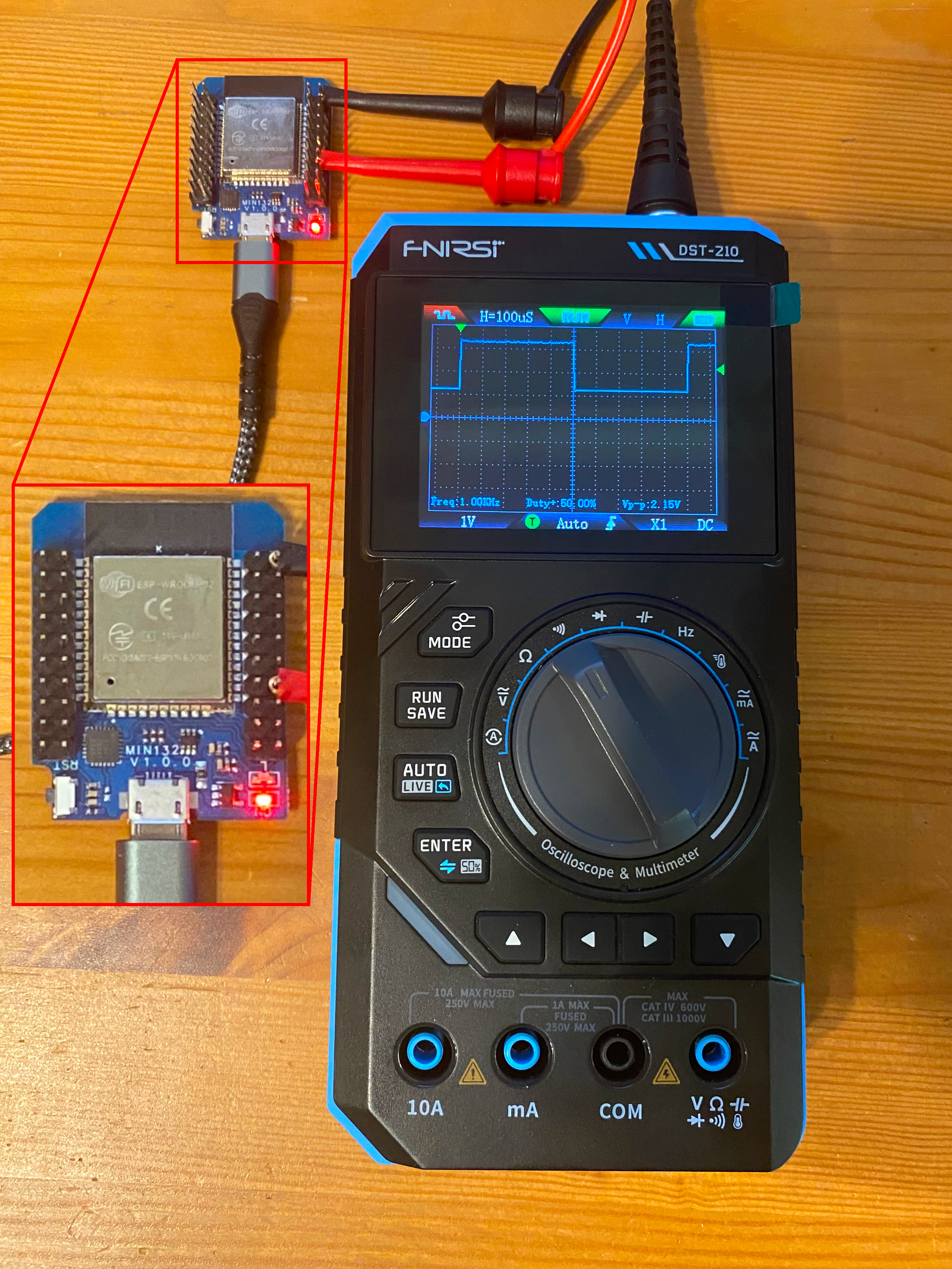

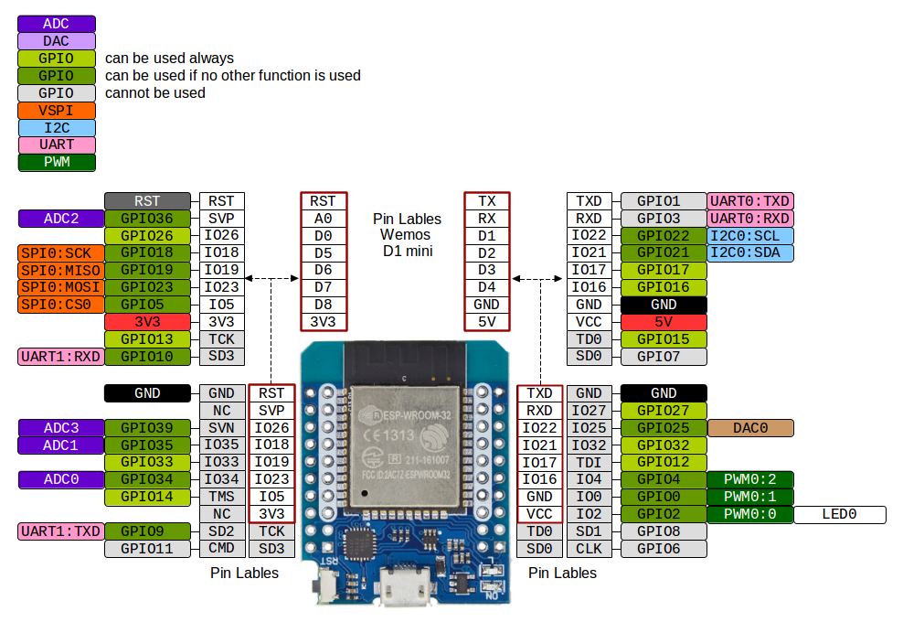

I have some ESP-WROOM-32 modules and I noticed that the PWM voltage on GPIO0 does not actually go to 0V. PWM on other pins behaves as expected. Here is a pinout of the ESP modules:
WROOM Mini D1 Pinout.png (253.5 KiB) Viewed 136 times
I attached the negative oscilloscope probe to the ground pin on the outside row of the right side GPIO header. The positive probe was attached to GPIO0.

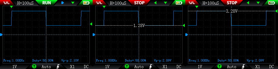

And here is the oscilloscope result:
Lastly, here is the code I'm using to generate the PWM. I'm using the Arduino IDE serial interface to adjust the PWM on two different pins (Channel 1 - GPIO2 & Channel 2 - GPIO0):

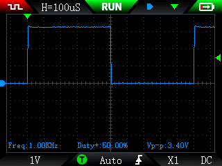

I think I can only attach three files, so I will reply with the oscilloscope result of Channel 1 (GPIO2) to show that it is normal.

Here is the oscilloscope result for Channel 1 (GPIO2):

Re: GPIO0 PWM Peak to Peak Voltage
Postby MicroController » Tue Jul 22, 2025 7:31 am
GPIO0 is a strapping pin and connected to the "auto programming" circuit and the USB-serial chip. This can interfere with any other signals you want to use it for. Better not use GPIO0 on a board with this circuit.
