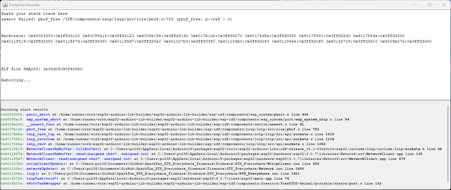

Hi Everyone,
I am using Arduino 3.0.7 NetworkClient on ESP32 Pico Mini 02 N8R2 to receive GNSS RTCM corrections from a NTRIP Caster / Server via TCP over WiFi.
I see occasional crashes due to an assert in LWIP pbuf_free. These happen rarely, every few hours.
I would like to understand if they are caused by a network timeout of some kind, or if a delay caused by my writing the RTCM to the GNSS and SD card (using SdFat) could be the cause.
The assert failure happens during a NetworkClient read:
I have tried using readBytes instead of read. That seems to make the crashes less frequent, but does not prevent them.
I recompiled lwip and enabled a bunch of debug messages. Here is the activity leading up to the crash:

assert failed: pbuf_free /IDF/components/lwip/lwip/src/core/pbuf.c:753 (pbuf_free: p->ref > 0)
Backtrace: 0x40083305:0x3ffd3160 0x40098ad9:0x3ffd3180 0x4009e25a:0x3ffd31a0 0x40177518:0x3ffd32d0 0x40172501:0x3ffd32f0 0x40174335:0x3ffd3330 0x401744ea:0x3ffd33b0 0x4011f08e:0x3ffd33d0 0x401027d6:0x3ffd3420 0x4011856c:0x3ffd3cb0 0x4011881a:0x3ffd3d20 0x4015dda8:0x3ffd3d40 0x4009b33e:0x3ffd3d60
ELF file SHA256: 895e3dde40850abf
Rebooting...

PaulZC
Posts: 8
Joined: Thu Jan 04, 2024 11:52 am
Re: LWIP ASSERT (pbuf_free: p->ref > 0) during NetworkClient read
Postby PaulZC » Sat Jul 26, 2025 1:02 pm
Thanks for reading...
I'm now 99% sure this is a simple case of PEBCAK, although it has had me scratching my head for several days.
The root cause was calling NetworkClient print (write) from a periodic task, with NetworkClient read being performed by the loop. The LWIP ASSERT (pbuf_free: p->ref > 0) was caused by the task trying to write midway through a read...
