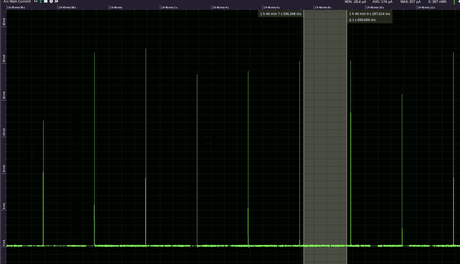

I am working with an ESP32-C5-WROOM-1 module and trying to achieve the Light-sleep minimal current consumption listed in the datasheet (Table 6-9), specifically 0.06 mA.
My setup:
- Chip/module: ESP32-C5-WROOM-1 on DevKitC
- ESP-IDF version: v5.5
- Power supply: USB via DevKitC
- Measurement method: jumper J5 with Otii
At the moment, I have reached value of 175 uA.
sdkconfig changes
# Power Management
CONFIG_PM_SLEEP_FUNC_IN_IRAM=y
CONFIG_PM_ENABLE=y
# CONFIG_PM_DFS_INIT_AUTO is not set
# CONFIG_PM_PROFILING is not set
# CONFIG_PM_TRACE is not set
CONFIG_PM_SLP_IRAM_OPT=y
CONFIG_PM_RTOS_IDLE_OPT=y
CONFIG_PM_SLP_DISABLE_GPIO=y
CONFIG_PM_SLP_DEFAULT_PARAMS_OPT=y
CONFIG_PM_LIGHTSLEEP_RTC_OSC_CAL_INTERVAL=2
CONFIG_PM_POWER_DOWN_CPU_IN_LIGHT_SLEEP=y
CONFIG_PM_POWER_DOWN_PERIPHERAL_IN_LIGHT_SLEEP=y
# CONFIG_PM_LIGHT_SLEEP_CALLBACKS is not set
# end of Power Management
CONFIG_FREERTOS_USE_TICKLESS_IDLE=y
CONFIG_FREERTOS_IDLE_TIME_BEFORE_SLEEP=3
CONFIG_ESP_SLEEP_POWER_DOWN_FLASH=y
main.c from example + pm_config:
static void light_sleep_task(void *args)
    while(1)
        esp_light_sleep_start();
void app_main(void)
    esp_pm_config_t pm_config = {
        .max_freq_mhz = 80,
        .min_freq_mhz = 80,
        .light_sleep_enable = true
    esp_pm_configure(&pm_config);
    example_register_timer_wakeup();
    xTaskCreate(light_sleep_task, "light_sleep_task", 4096, NULL, 6, NULL);
Can I reduce energy consumption even more in Light Sleep mode?
otii power consumption
Снимок экрана 2025-08-11 141823.png (238.36 KiB) Viewed 459 times
light_sleep.rar
LightSleep project
(79.97 KiB) Downloaded 20 times

I also met the same question, can't achieve the current in the datasheet.(0.06mA)
By the way, can you achieve the current in the datasheet(0.25mA, peripheral clock disabled)?
nikolays@ar-sw.com
Joined: Mon Aug 11, 2025 5:53 am
Re: ESP32-C5 Light-Sleep minimal power consumption
Postby nikolays@ar-sw.com » Wed Aug 13, 2025 7:47 am
As far as I understand, the call
It will do it for me. I get about 175uA instead of 250uA(datasheet)
Also, if disable console output(UART0), energy consumption is reduced to ~ 125uA
qingqingxu
Joined: Fri Jul 18, 2025 3:07 am
Postby qingqingxu » Thu Aug 14, 2025 2:39 am
So, I want to know how to close peripheral clock to achieve 0.25mA in the datasheet?
And how to configure code to achieve 0.06mA in the datasheet?

One thing I rarely see mentioned in threads like this is that the DevKitC itself, not the ESP32-C5 module — can be a big reason why you never hit the datasheet light-sleep numbers. The onboard USB-to-UART chip (CP2102/NCP210x or similar), LDO regulator quiescent current, power indicator LED, and even the leakage through ESD diodes can easily add tens or even hundreds of microamps. If you really want to get close to the 0.06 mA in Table 6-9, you’ll need to either cut those off the board (literally remove LEDs, isolate VCC pins to the USB chip) or move the module to a minimal custom PCB powered directly from a low-Iq regulator or a clean battery source. The datasheet numbers are for the bare module in ideal conditions, not for a development board via USB.
