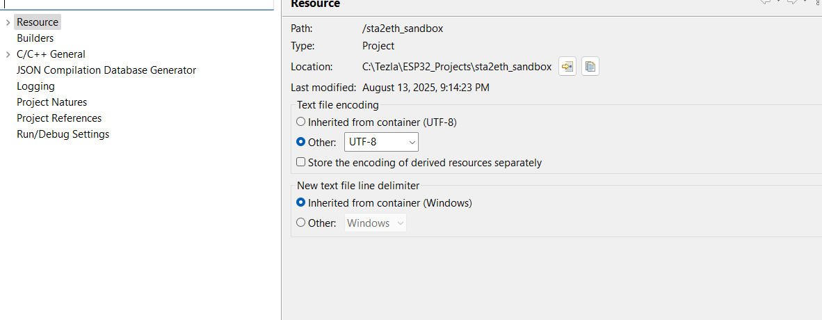

I am using Espressif IDE with Eclipse for ESP32 development. I downloaded and did the offline install of the latest version. I created a new Espressif project from the menu and loaded a default example. When I go into the properties the attached image shows the selection choices I have. However I notice there is NO C/C++ Build properties? Why is this?

The C/C++ Build Properties preference page is not applicable for CMake projects. Espressif-IDE only supports CMake projects.
Please let us know what you would like to check and configure through the Build Properties.
