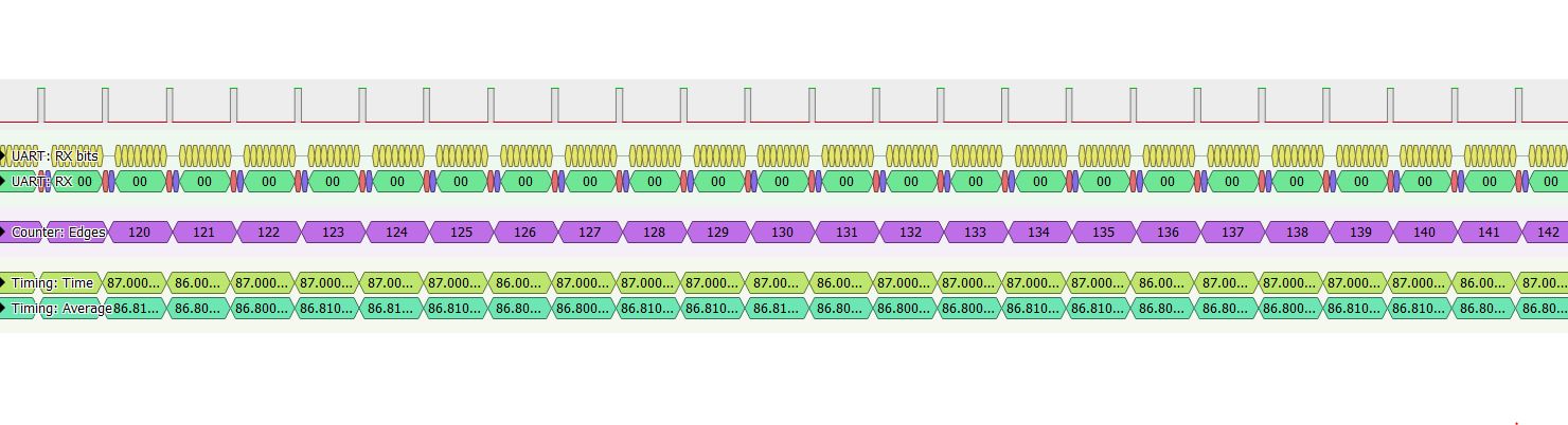

I'm using ESP32-S3 and encountering occasional delays when sending more than 128 bytes (e.g., 200 bytes) via uart_write_bytes().
Normally, the notification completes within about 10ms, but sometimes it takes between 50ms and 200ms.
Even after setting the task priority to the maximum (24), the issue still occurs.
I suspect that some interrupt handling inside ESP-IDF might be causing this behavior.
Does anyone know what might be causing this or how to resolve it?

This issue involves sending 200 bytes of data, for example.
After transmitting the first 128 bytes, an interval of 50 to 200 milliseconds occurs,
followed by the transmission of the remaining 72 bytes.
This behavior has been confirmed using an oscilloscope.
We would like to understand why this behavior occurs and request a solution.

Postby ok-home » Fri Oct 03, 2025 6:45 am
causes a 50-200ms pause on the UART TX in the middle of the transmission?
Yes,the following processing is implemented, causing a pause of 50 to 200 milliseconds during transfer.
The task running this process has the highest priority.
    uart_write_bytes(UART_NUM_1, buffer, 200);
Maybe I'm doing something wrong.
Sending 500 bytes, without any intervals.
For example, a screenshot from the analyzer - 120-140 characters.
