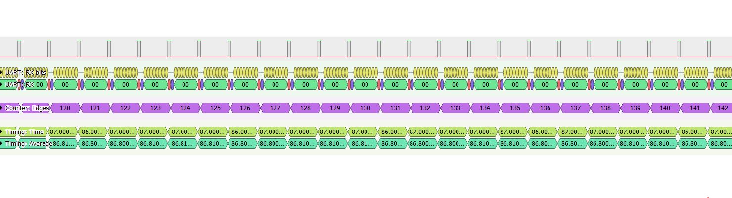

Maybe I'm doing something wrong.
Sending 500 bytes, without any intervals.
For example, a screenshot from the analyzer - 120-140 characters.

Re: Delay or interrupt when sending more than 128 bytes via UART on ESP32-S3
Posted: Fri Oct 10, 2025 1:43 am
by ok-home
The differences from my environment are as follows.
.parity = UART_PARITY_EVEN,
.source_clk = UART_SCLK_APB,
  RX_BUF_SIZE * 2・・・18KB
Could these differences be affecting it...?
Could you please try it with the same settings?
no difference at speeds from 115200 to 1500000
