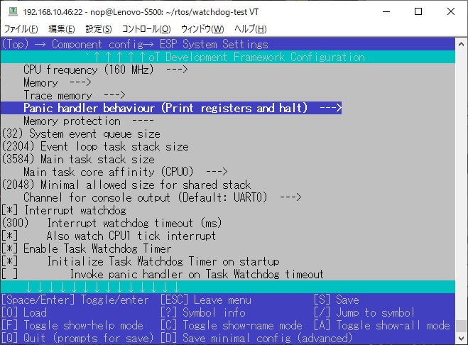

nopnop2002
Posts: 347
Contact:
Re: Watchdog Reset (TG1WDT_SYS_RST)
Postby nopnop2002 » Sun Nov 09, 2025 11:17 pm
can't replicate the error and i can't understand the state of esp32 before the panic handler.
When a task watchdog alert or interrupt watchdog alert occurs, it will transition to Halt instead of Reset.
