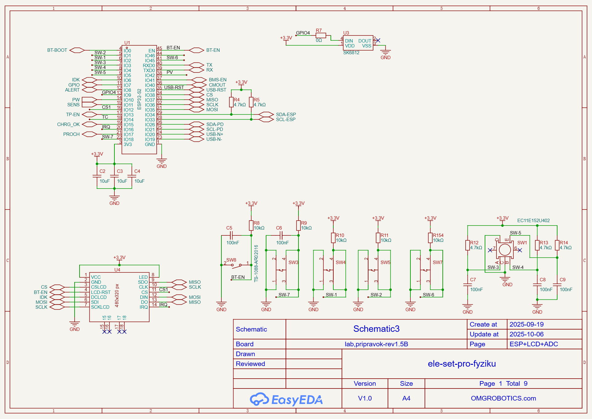

I have this module on a custom board. when I reset it, it enters a boot reset loop, dumping this into serial:
rst:0x3 (RTC_SW_SYS_RST),boot:0x1b (SPI_FAST_FLASH_BOOT)
Saved PC:0x400512fe
SPIWP:0xee
mode:DIO, clock div:1
load:0x3ffe6100,len:0x524
load:0x4004c000,len:0xa70
load:0x40050000,len:0x2958
entry 0x4004c18c
ESP-ROM:esp32s2-rc4-20191025
Build:Oct 25 2019The code is just a LED blink with serial:

monitor_filters = esp32_exception_decoderI checked power with oscilloscope, the 3V3 is solid.
Basically all pins are connected to something. Are there any specific pins I should check?
