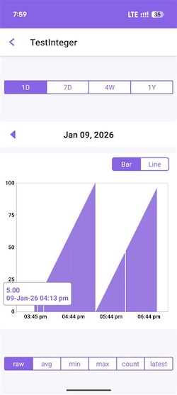

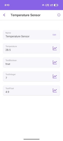

@lichurbagan That's not true. The phone apps indeed support multiple time series parameters. I am not sure where you gathered the info about the known limitation. Can you please elaborate?
