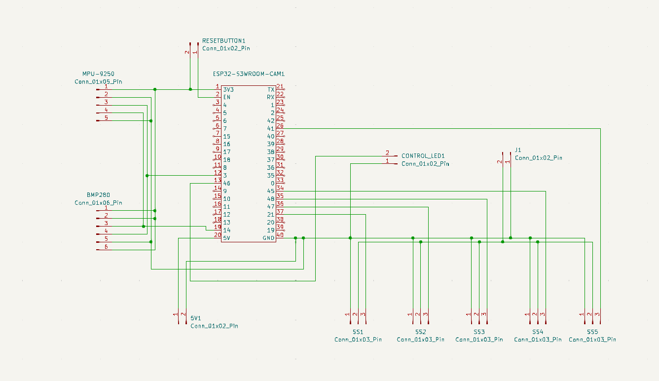

Hi, I'm having trouble powering my ESP32 S3 CAM ESP32-S3 by applying 5V to the 5V pin. The ESP doesn't respond, the "ON" LED doesn't light up, and there's no voltage on the 3.3V pin. However, when I connect the ESP to my computer via USB cable, everything works fine. The problem is the power supply from a 2s LiPo battery -> 5V regulator -> ESP. The voltages are definitely 5V, as I measured them with a multimeter. Thanks for any help.

Hello, can you post a picture/ ckt diagram of your connection?

The ESP is connected to an MPU9250 accelerometer, a barometer, and five servos. The servos are powered by 6V. The power supply is a simple 2s lipo connected to a 5V regulator or step-down switch for these servos.Hello, can you post a picture/ ckt diagram of your connection?
- Diagram
- esp.png (45.4 KiB) Viewed 4302 times
Re: ESP32S3 does not work when powered on 5V pin
If it works when connected po a pc but not when is direct powered by 5V, then the cause might be the 2 transistors used to generate reset and boot signals by the usb to serial converter. Not sure if your board has them but it worth to check the state of reset pin. if low when powered by 5V, but high when connected to PC then most likely you have the 2 transistors, and they are not working properly.
Give us the exact name of your s3 cam board or identifier.

When I connect it to PC, the reset pin is high, but when its connected to 5V, reset pin is low.If it works when connected po a pc but not when is direct powered by 5V, then the cause might be the 2 transistors used to generate reset and boot signals by the usb to serial converter. Not sure if your board has them but it worth to check the state of reset pin. if low when powered by 5V, but high when connected to PC then most likely you have the 2 transistors, and they are not working properly.
My board: ESP32-S3-WROOM
