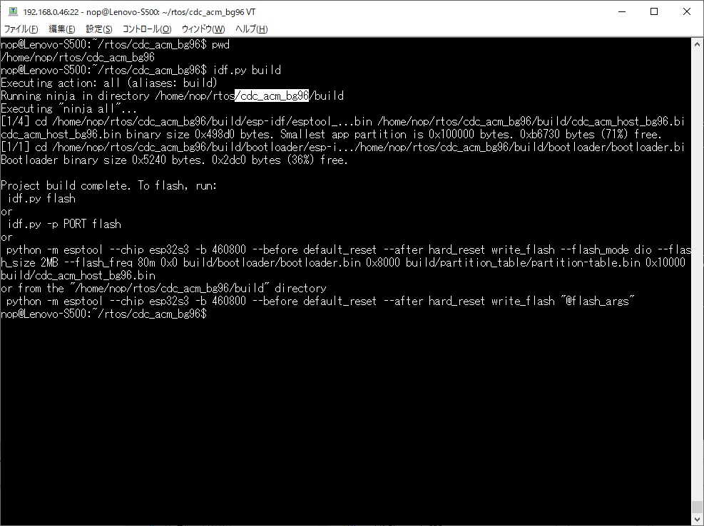

I tried to move the bg96 code over to the 5.1 version it was a never ending nightmare of differences and never compiled.
The cdc_acm_bg96 sample code was able to build with ESP-IDF V5.5.
I don't have a Quectel BG96 LTE/GPS so I'm not sure if it will work properly.
The usb_host_cdc_acm component must use V1.
## IDF Component Manager Manifest File
dependencies:
idf: ">=4.4"
igrr/libnmea: "^0.1.1"
usb_host_cdc_acm: "1.*"- Attachments
- cdc_acm_bg96.jpg (174.48 KiB) Viewed 3468 times
