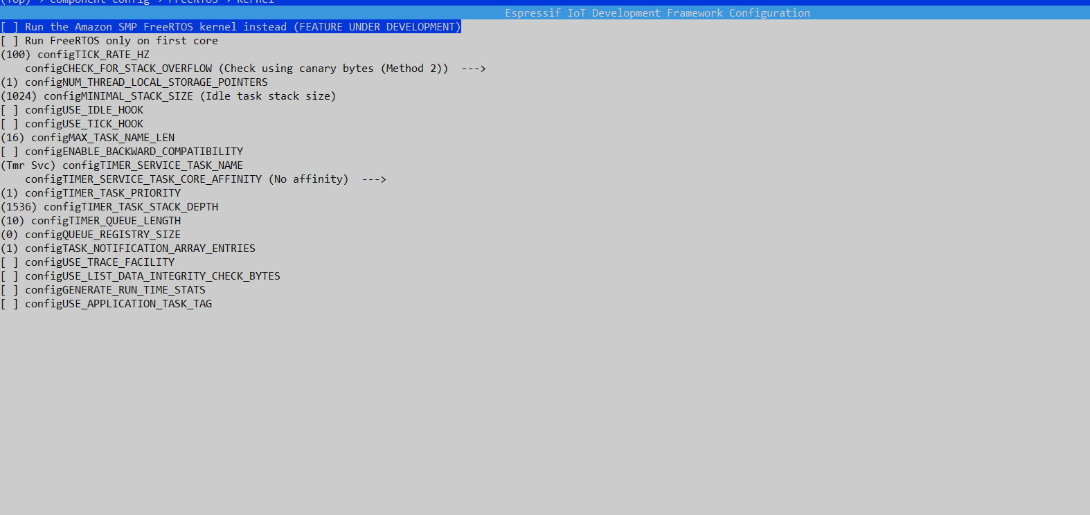

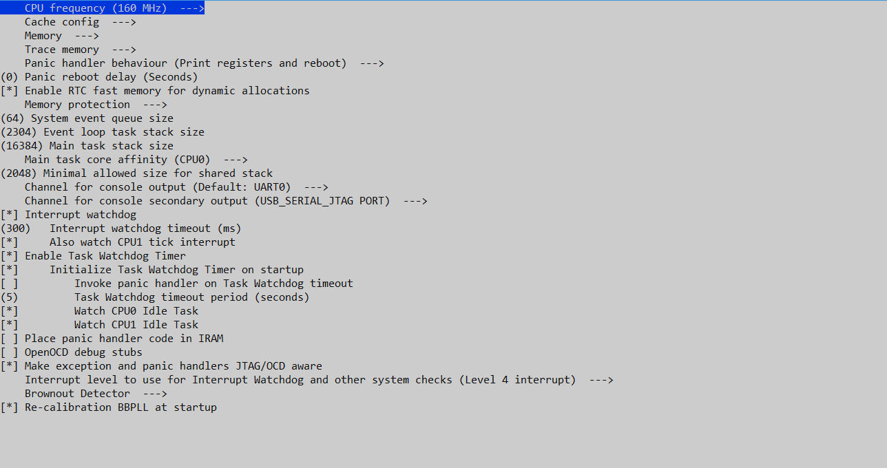

Hello ,
In below main.c file i am running task ,task1 from to ...... task21 and in this task wifi_rssi_monitor_task try to download 29kb data using call api and http ,
case 1:
if total number of task is 15 used than i can download proper data every time
case 2:
if i increase number of task 16 to 21 or more i an unable to download proper data
i change in menuconfig file which is mention in below screenshoot
my code output :
================= SYSTEM MONITOR =================
Free heap: 139224 bytes
Minimum ever free heap: 132288 bytes

can you guide me how to solve this issue so i can download data properly , i hope we will connect as soon as possible

Postby lichurbagan » Tue Dec 09, 2025 4:35 pm
Your issue is low free heap during HTTP downloads. More tasks reduce memory and fragment the heap. TLS and HTTP buffers then fail to allocate. Reduce each task’s stack size. Shrink HTTP client buffers. Lower TLS buffer settings. Avoid creating and deleting many tasks. Use one shared HTTP worker task. Keep free heap above 50 KB during downloads. These changes stabilize memory and stop partial reads.

Postby Ambimat » Wed Dec 10, 2025 5:54 am
I can not reduce task size because I need more than 20 tasks than how to reduce heap size or free ,I will share my http logic please review it also
