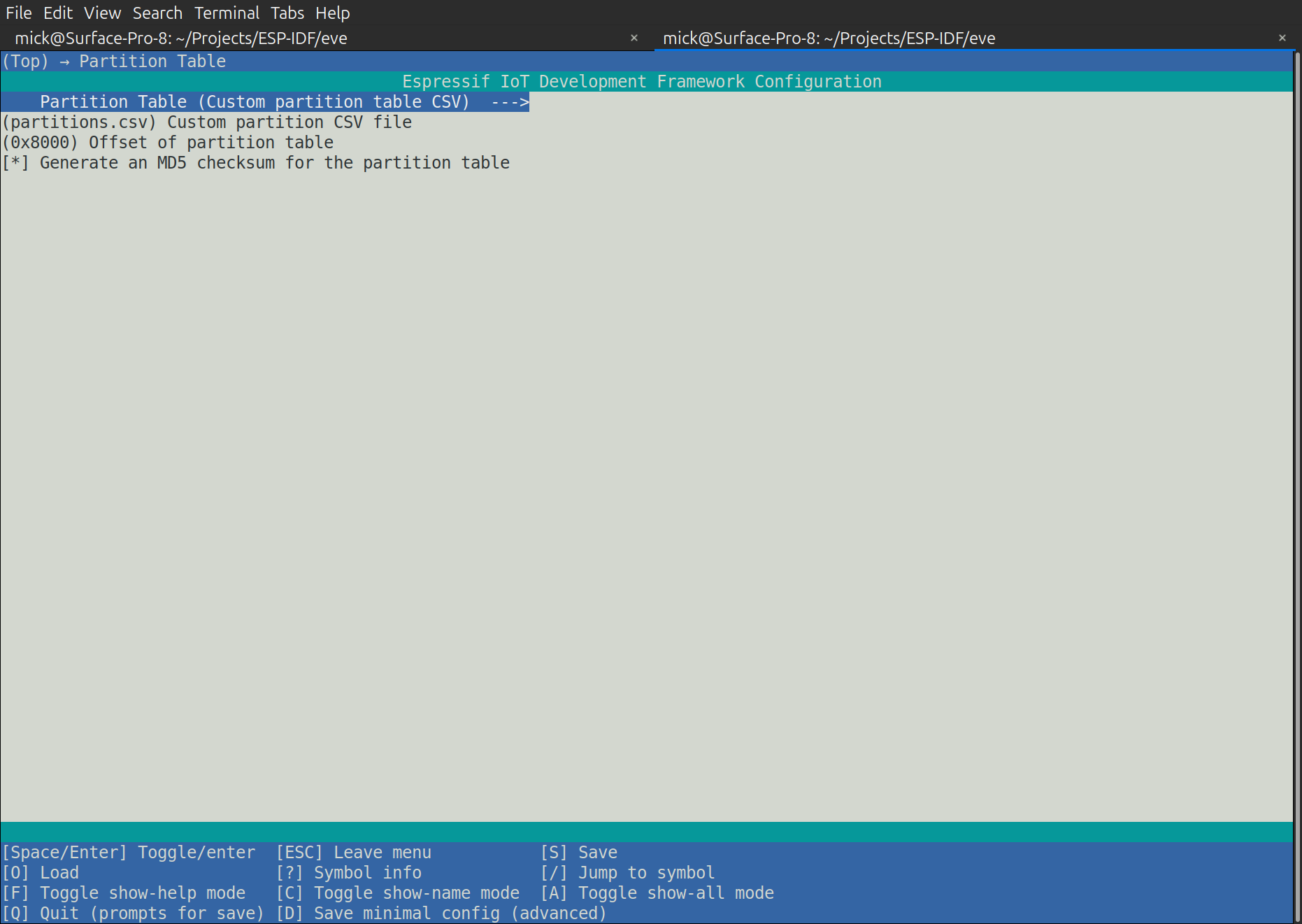

[*]Created the partition table $PROJECT_DIR/partitions.csv:
# ESP-IDF Partition Table
# This partition table is design for 16 or 32 MB flash
# Name,          Type, SubType, Offset,   Size, Flags
nvs,            data,   nvs,        0x009000,  24K,
phy_init,       data,   phy,        0x00f000,   4K,
factory,        app,    factory,    0x010000,   1M,
storage,        data,   fat,                ,   8M,

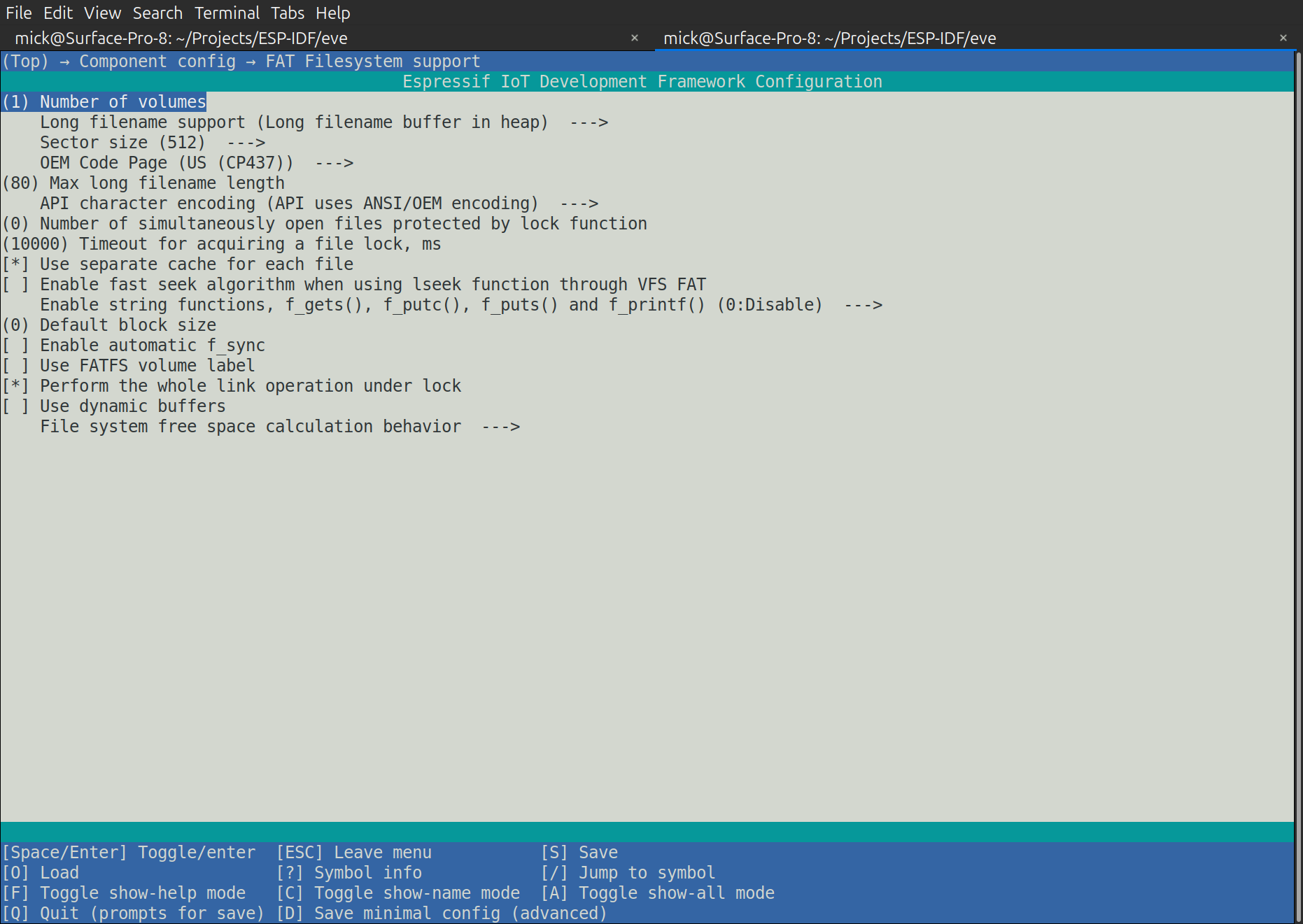

[*]Enabled my own partition table in the configuration. See "Screenshot 1" in the attachment,
[*]and set up FAT filesystem support (see "Screenshot 2").

I set "format_if_mount_failed" to "false" and flash a prepared partition from file! When I set it to "true", my code works also, but it formats the FAT partition and the files are lost!
The error must reside in the partition creation by the script "$IDF_PATH/components/fatfs/fatfsgen.py". May be it creates an incompatible partition file.
MickPF
Posts: 62
Joined: Tue Apr 03, 2018 8:47 pm
Re: Need help mounting a FAT partition
Postby MickPF » Fri Dec 26, 2025 2:20 am
The cause of the error lies in the sector size:
It doesn't work with sector_size=512, but it works with sector_size=4096!

integrating creation of and flashing my FAT partition in the file "$PROJECT_DIR/main/CMakeLists.txt by the line
fatfs_create_spiflash_image( "storage" "${PROJECT_DIR}/fat_partition" FLASH_IN_PROJECT )
creates a partition with sector size of 4096 bytes!
I could not find any way to change it to 512 bytes!
Maybe you know that way...
I can accept the sector size of 4096 bytes...
Thanks for your help...
Doesn't work with wear-levelling apparently:
'sector_size' / Int32ul,  # always 4096 for the types of NOR flash supported by ESP-IDF!
self.total_sectors = self.partition_size // FATDefaults.WL_SECTOR_SIZE
Last edited by MicroController on Fri Jan 02, 2026 1:01 pm, edited 2 times in total.

I made this setting right at the beginning, but it resulted in the creation of a partition that couldn't be mounted!
Like I said, I accept the sector size of 4096 bytes. The main thing is that it works. And it does!
