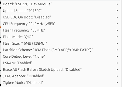

Hi, Can someone please provide me with a guide to the best Tools settings or explanation for the above processor
- Erase Flash before Sketch upload = enables/disabled
- Flash Mode = QIO/DIO
- Flash Size = 4,8,2,16
- PSRAM = enabled/disabled
and in particular the many options for
- Partition Scheme

Assuming you have the Waveshare esp32-c5-kit that has been showing up on Amazon,
Screenshot from 2026-01-03 13-18-00.png (40.64 KiB) Viewed 1422 times
Then plug into the UART port

Many thanks for that... I'll give it a whirl
