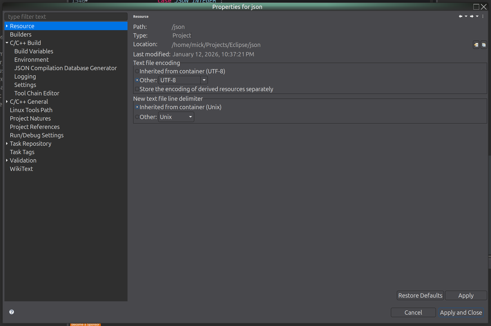

To make software development with ESP-IDF a bit more convenient, I installed Espressif IDE 4.0 and, after several failed attempts, finally configured it correctly and completely. I got problems with the "Espressif IDF Manager."
In my project, which I created using "File → New → Espressif IDF Project," I have the directory "$PROJECT_DIR/include" where I placed all the include files for the project.
However, Espressif IDE only partially finds these include files, as well as some of the ESP-IDF include files. The "C/C++ Build" entry is missing from the "Project Properties" (see the image "Project Properties Espressif IDE" in the attachments). This is where you can specify the directories containing project-specific includes under "Settings," something I'm used to from Eclipse (see the image "Project Properties Eclipse" in the attachments).
Did I do something wrong when setting up the project in Espressif IDE?

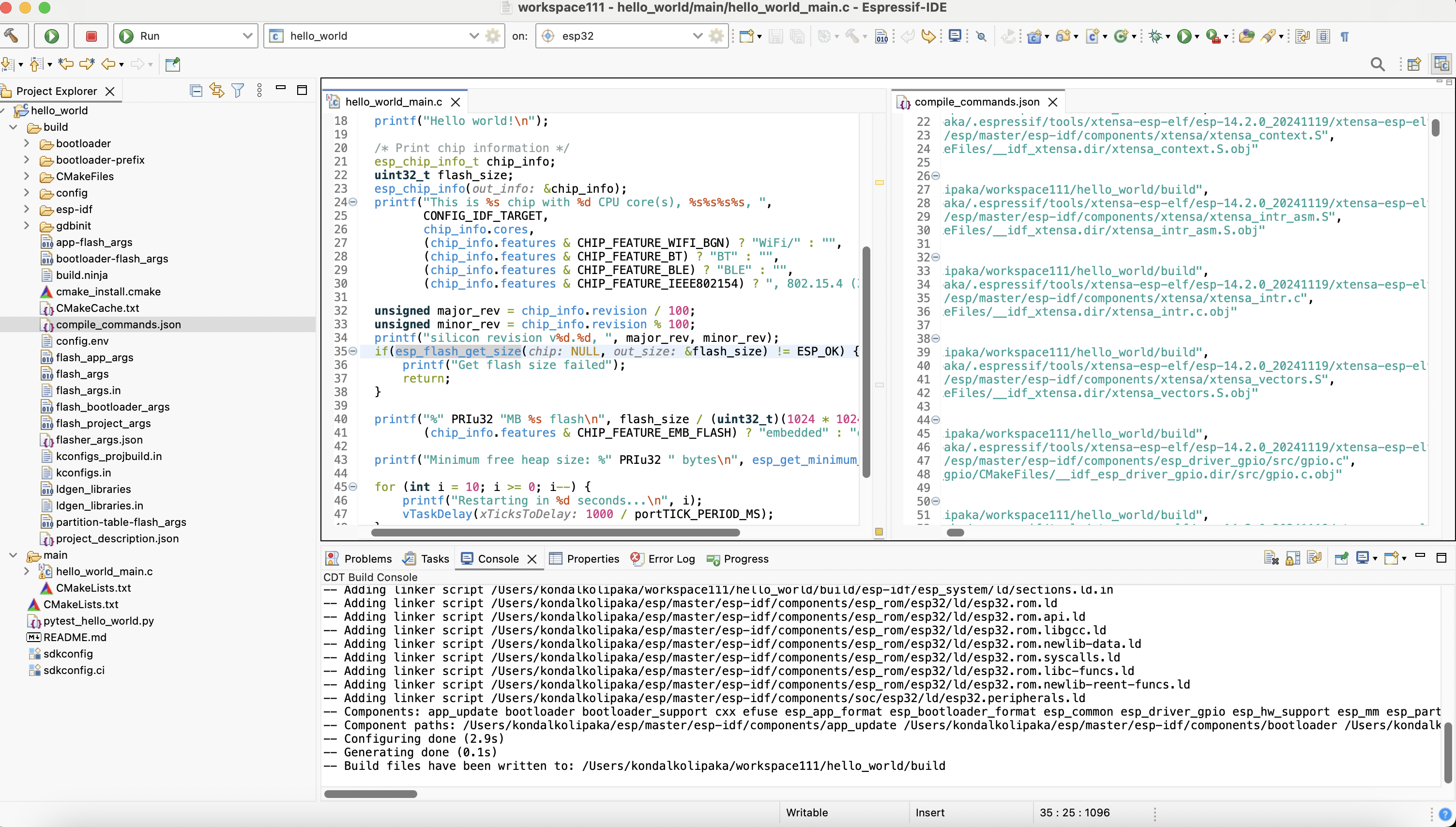

Re: Need help with Espressif IDE 4.0
In Espressif-IDE, you don’t need to configure any includes in the project properties, as it uses compile_commands.json as the source of truth for resolving include paths and headers.
https://docs.espressif.com/projects/esp ... -workspace
Here are the steps:
1.Install Espressif-IDE
2.Open Espressif > ESP-IDF Manager
3.Configure ESP-IDF using the ESP-IDF Installation Manager tool
4.Create a new project using templates

Agreed! In Espressif-IDE, the include path information is derived from compile_commands.json (generated by the build system) and used by clangd to resolve declarations.
Could you please be more specific about the issue you’re facing, or share a sample project you’re working with, so that we can help you further?
Here is the sample project which I've built in my workspace To manage esp-idf versions, we have a new tool called EIM, please check the guide here https://docs.espressif.com/projects/esp ... stallation

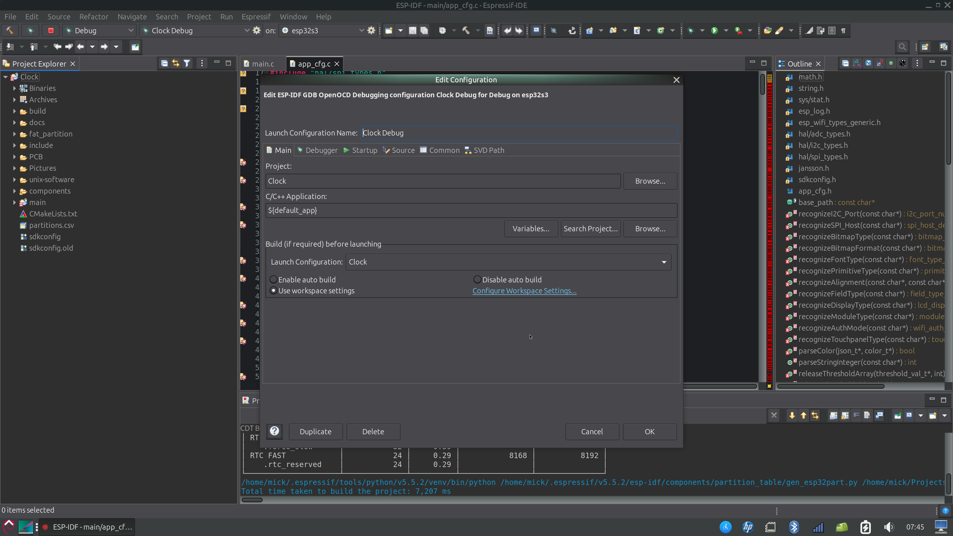

I'm sorry, I haven't had time to reply here until now!

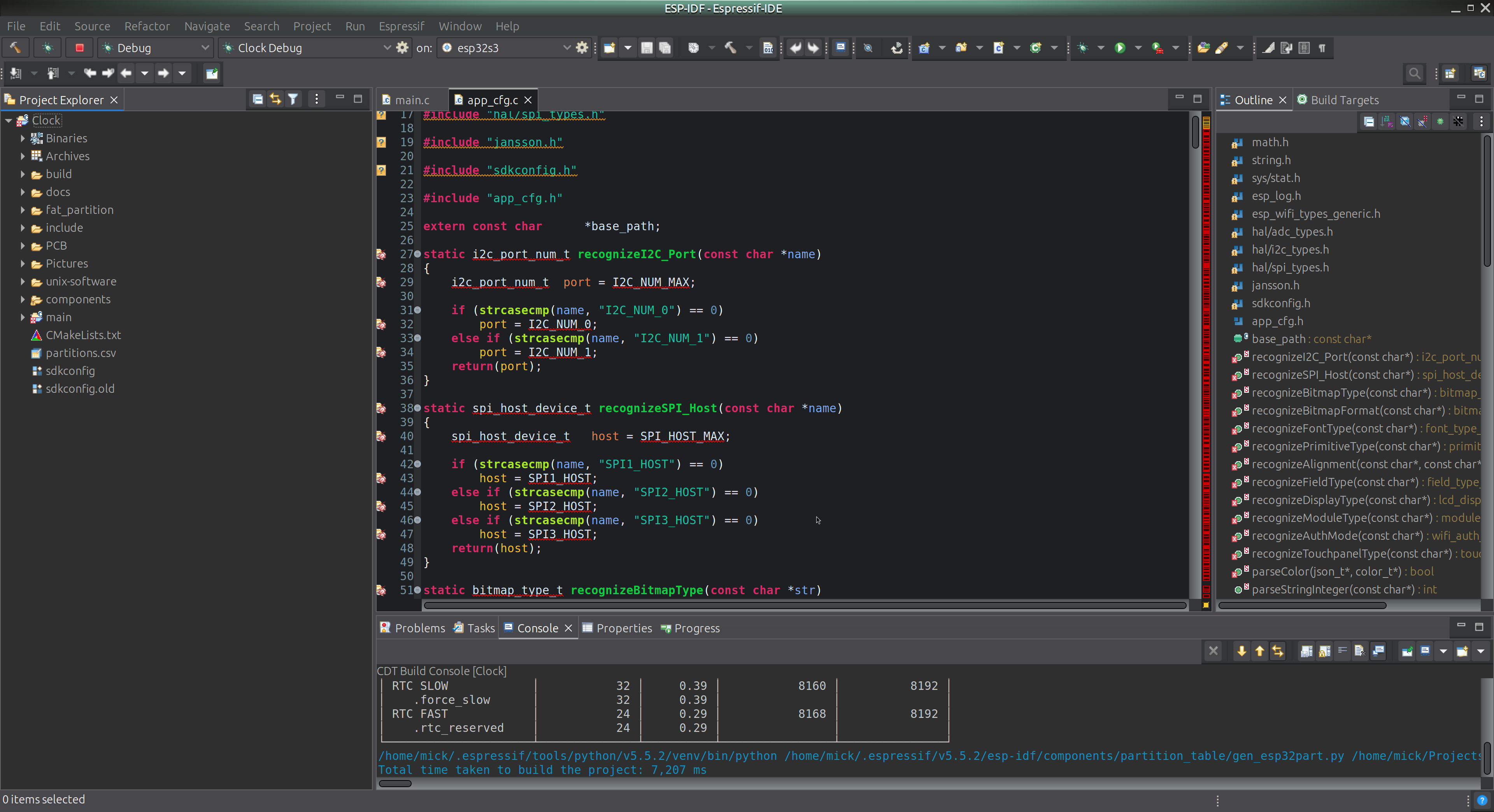

The attached image "Screenshot_3.png" shows the problem in the editor area.

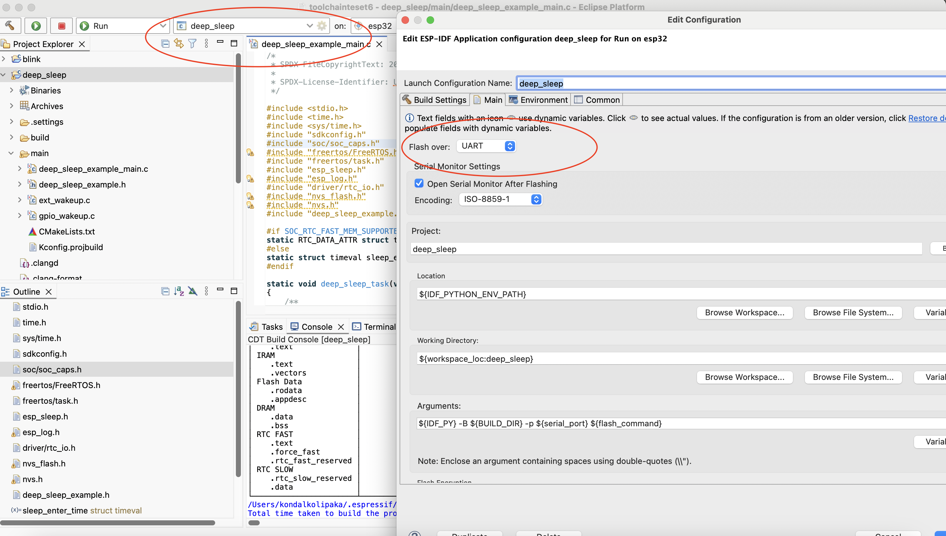

I wanted to flash the app and my FAT partition from within the IDE via the connector "USB"/"JTAG" of the "ESP32S3 DevKitC-1" module, but it's not working. I found the page https://docs.espressif.com/projects/esp ... agflashing in the IDE documentation. However, the dialog box on that page looks different from my window (attached image "Screenshot_4.png"). The "Flash over" option is missing!
I'm gradually getting the impression that the Espressif IDE, just like Microsoft Visual Studio Code itself and the Espressif plugin for Eclipse CDT, is just garbage! Features are promised or described in the documentation that don't actually exist or don't work! I'm very disappointed!
There are mutliple observations in the screenshots attached.
1. You're looking at the debug configuration wizard, you should check launch configuration wizard, please check this guide.
https://docs.espressif.com/projects/esp ... the-device

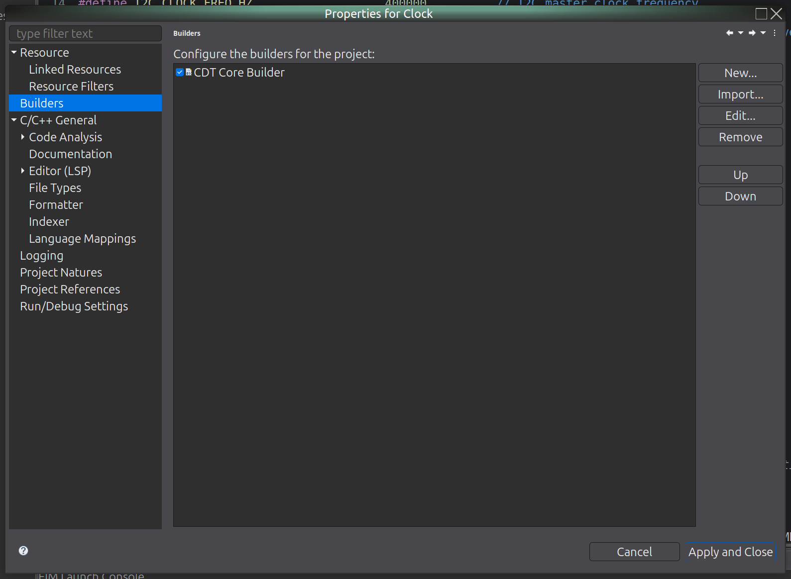

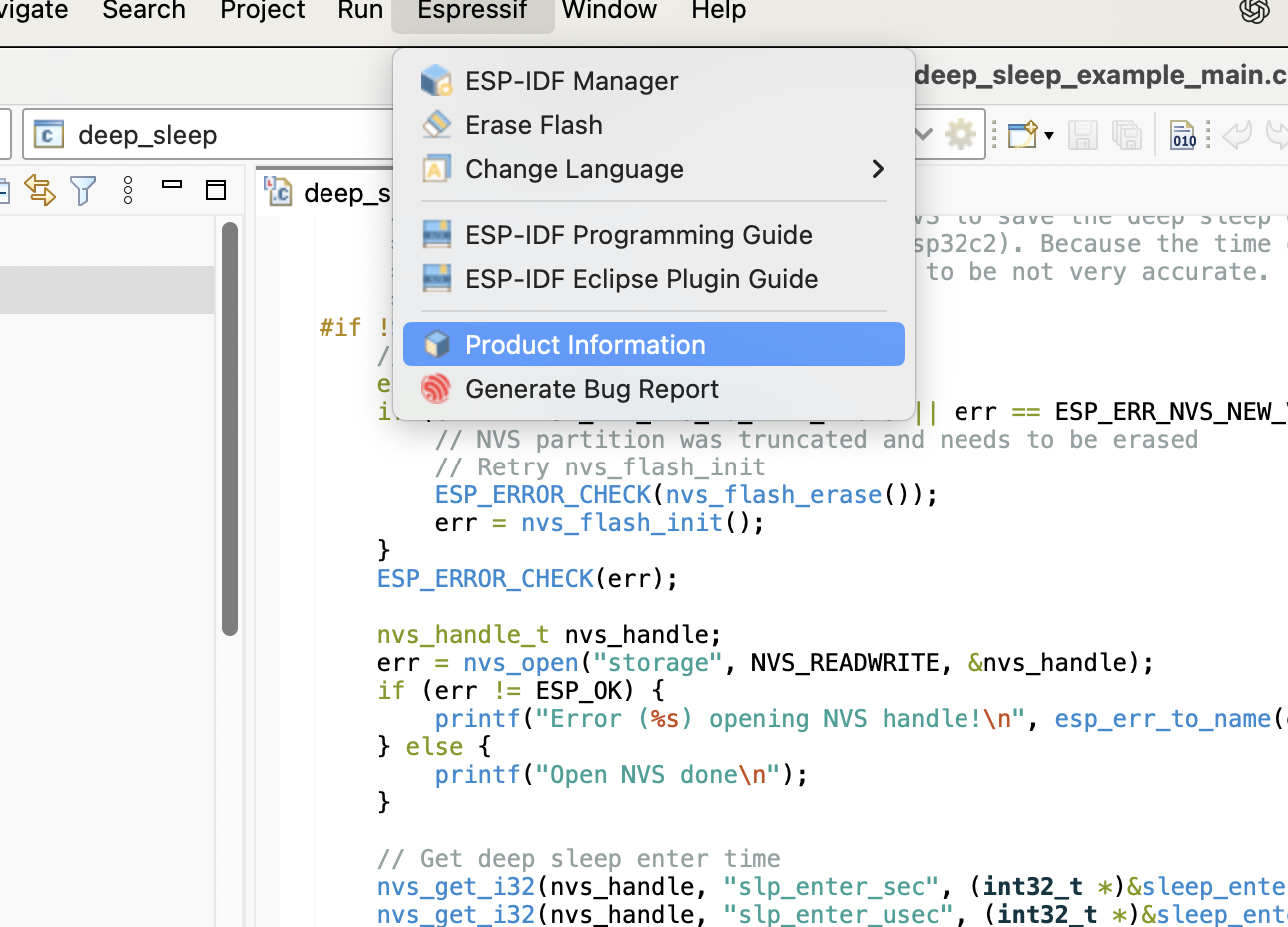

2. Code editor which you've attached is showing standard C/C++ editor not LSP based editor which espressif-ide v4.0 by default has - I wonder, are you using v4.0?
Please check "Espressif >> Production Information" and look for "IDF Eclipse Plugin Version".

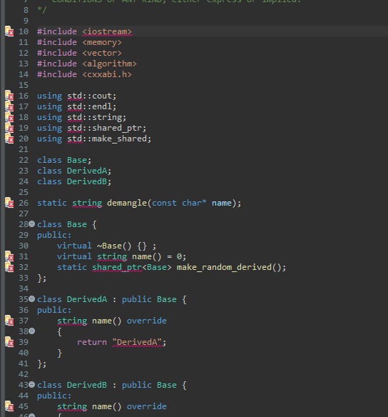

I have a problem. I'm developing a project in C++ using the Eapressif-ide environment, and eitoe is giving me errors that it can't find C++ libraries and even C libraries, but it compiles correctly.
