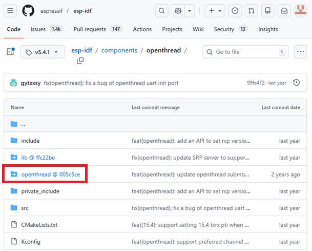

The error seems to be related to openthread component. Retracing the cloning procedure of the esp-idf repository, I believe that the problem is linked to the fact that it was not possible to perform the checkout on commit 005c5cefc22aaf0396e4327ee7f2e0ad32a7733b of the 'components/openthread/openthread' submodule, like it is visible from the following log

I managed to complete compilation with ESP-IDF v5.4.1 by manually downloading and replacing the openthread submodule:
So my problem is basically solved. Anyway, could you please elaborate a bit about the problem with openthread checkout? Is this a known problem or did I do something wrong?

Hi, I am not sure why your submodule updating fails, It is possible that the remote repo URL of openthread is wrong so that it cannot find the commit ID. You can try to use `git submodule sync --recursive` to make git use the right URL for the openthread submodule.

I tried using 'git submodule sync --recursive' prior to 'git submodule update --init --recursive' but this didn't solve the problem: the checkout of '005c5cefc22aaf0396e4327ee7f2e0ad32a7733b' of openthread still fails.
