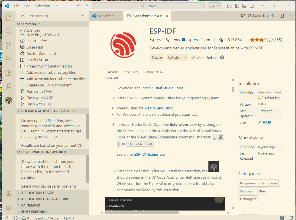

Hello, I just installed Vscode + ESP-IDF latest version, but the examples don't appear in the tree menu. I also tried searching for them with Ctrl + Shift + P, but nothing works. Could you please help me. If you can also point me to a small ESP32 project to try, thank you in advance. I'm attaching the installation.

When you create a new project via the IDF extension (CTRL+E N), you can select which of the examples you want the project to be created from.
