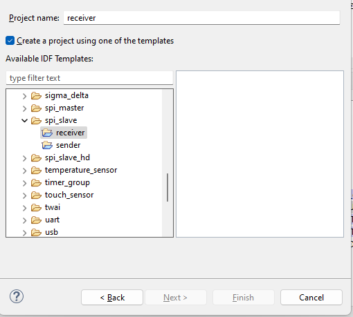

Dear Espressif Support Team,
We are using the ESP32-C6 module on our custom embedded board. The ESP32-C6 is connected to another microcontroller via SPI on the same PCB.
System Configuration:
ESP32-C6 configured as SPI Slave
External MCU configured as SPI Master
Development framework: ESP-IDF
Example used: spi_slave (receiver example)
Esp32C6 SpiReceive.png (21.66 KiB) Viewed 185 times
SPI receive function used: spi_slave_transmit(RCV_HOST, &t, portMAX_DELAY)
Current Setup:
SPI clock from master: 50 MHz
Packet size: 1024 bytes
2 ms delay between packets (required for stable communication)
We are able to receive data correctly when a 2 ms delay is inserted between packets on the master side. However, if we remove this delay, packets are lost.

We have reduced the master clock frequency to 32 MHz, then also, we are still observing the same issue as before.
Please let us know the next steps for further debugging or if any additional information is required from our side.

Postby MicroController » Fri Feb 13, 2026 1:26 pm
Try spi_slave_queue_trans() to make sure there's at least one transaction 'in flight' at any time.
