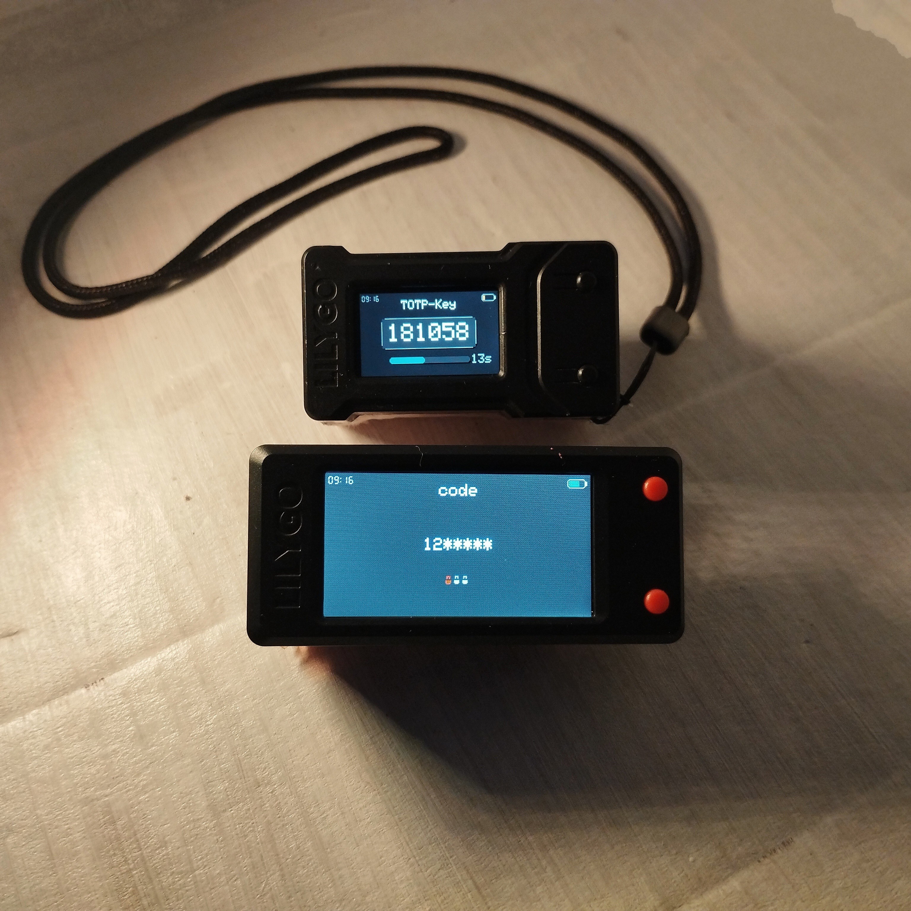

The device is built on the LILYGO T-Display ESP32 board, which gives us:
  • - Dual-core ESP32 processor with hardware AES encryption
    - 1.14" color TFT display (135×240 ST7789)
    - Two physical buttons for navigation
    - Built-in battery charging circuit
    - WiFi and Bluetooth 5.0 LE
    - Optional DS3231 RTC module for accurate offline timekeeping (I2C, SDA/SCL)
### Core Functionality
TOTP / HOTP Authenticator Mode:
The device generates time-based one-time passwords (TOTP) compatible with Google Authenticator, Microsoft Authenticator, Authy, and all RFC 6238 services. After initial NTP time sync via WiFi, it works completely offline. Each code rotates every 30 seconds with a visual countdown timer.
HOTP (counter-based, RFC 4226) is also supported — press both buttons to generate the next code. The counter increments atomically and is written to flash after button release, preventing desync on battery power.
With a DS3231 RTC module connected, TOTP works accurately in AP mode and fully air-gapped Offline mode — no WiFi or internet required.

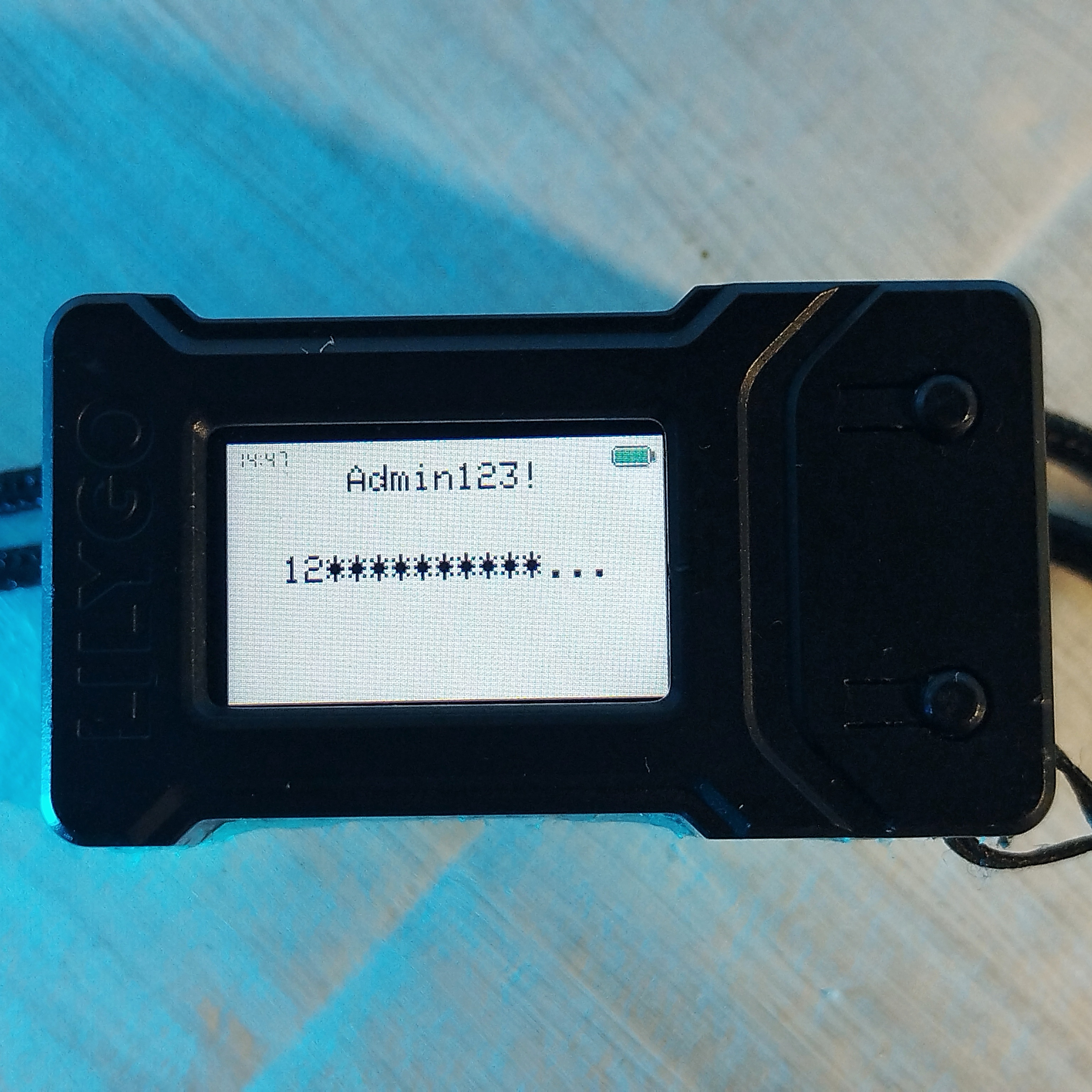

Password Manager Mode:
Stores AES-256-GCM encrypted passwords locally. Press both buttons and the device connects via BLE HID keyboard to type your password automatically — no clipboard, no typing, no shoulder surfing. PIN protection on the device side prevents unauthorized BLE transmission.

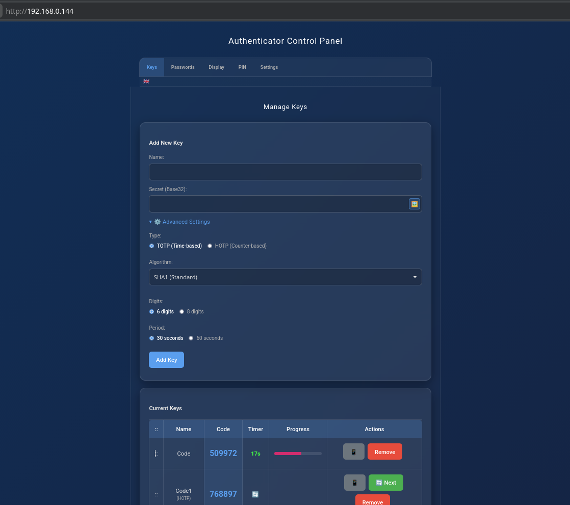

WiFi Client Mode:
Connects to your network. NTP time sync for accurate TOTP. Web management interface accessible from any browser on the network.
Access Point Mode:
Device creates its own isolated WiFi hotspot. Web interface at 192.168.4.1. All 8 security layers active. QR code on screen for easy connection. TOTP works via DS3231 RTC without internet.
