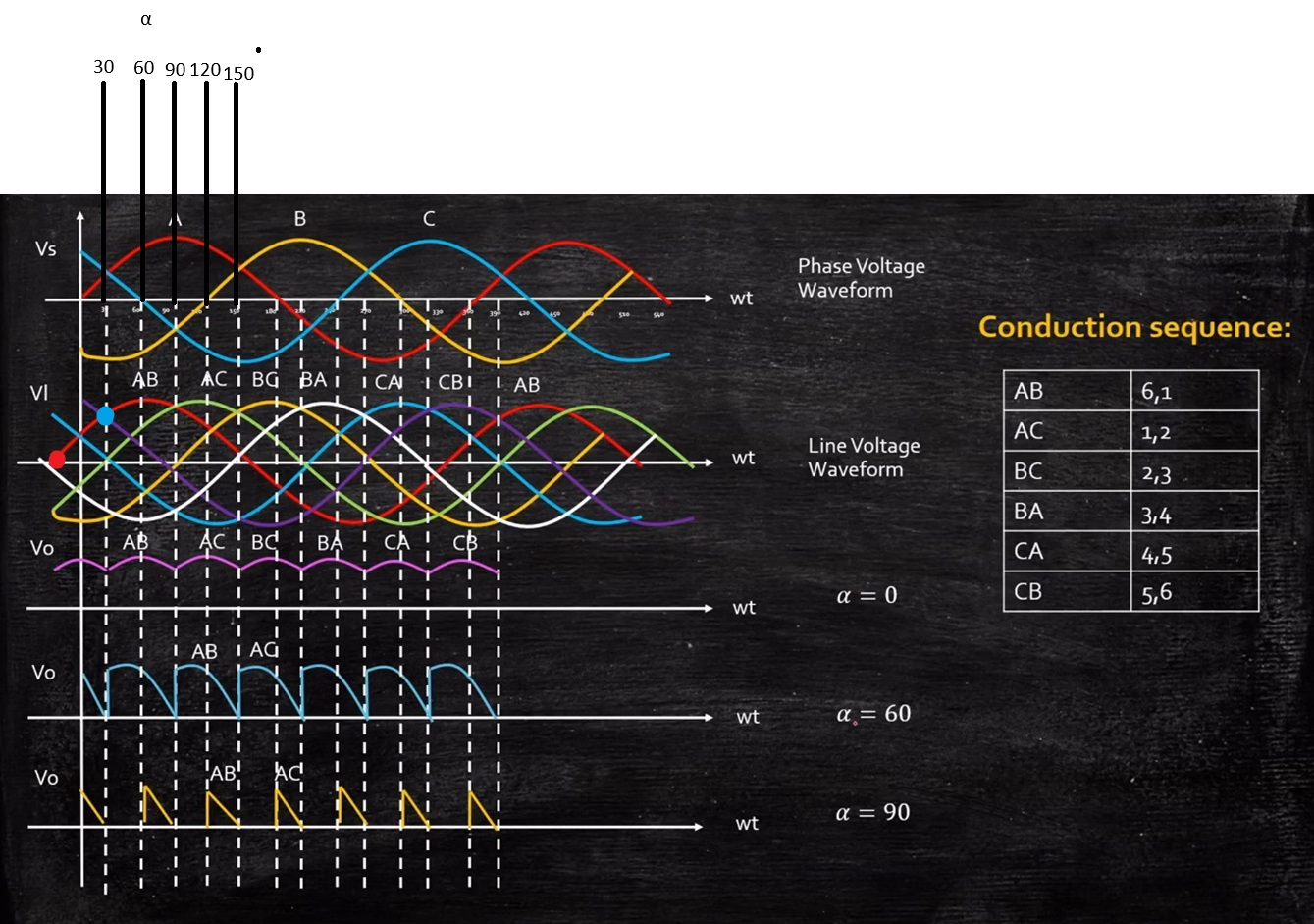

Postby PingwinVonJelen » Sun Mar 15, 2026 11:45 am
So core of the working principle is this (pic)
When AB voltage is slightly above zero, i get interrupt from optocoupler. ( Red dot)
Now we need to wait to α = 30 (3333us from interrupt)
We are now at blue dot.
Now we need to start firing thyristors, first is AB pair at α = 30, next is AC pair at α = 90, and so on to the CB at α = 330
Cycle ends and is started from the beggining.
Notice that, when CB conduction is still going on, we have already interrupt, so this cant block each other.
Curcuit is regulating output voltage by delaying thyristor fire ( for now lets focus on program core, this feature can be easily added later)
In real world big thyristors need to be fired in whole time of conduction to ensure proper operation, that's why im outputting pwm instead of pulses

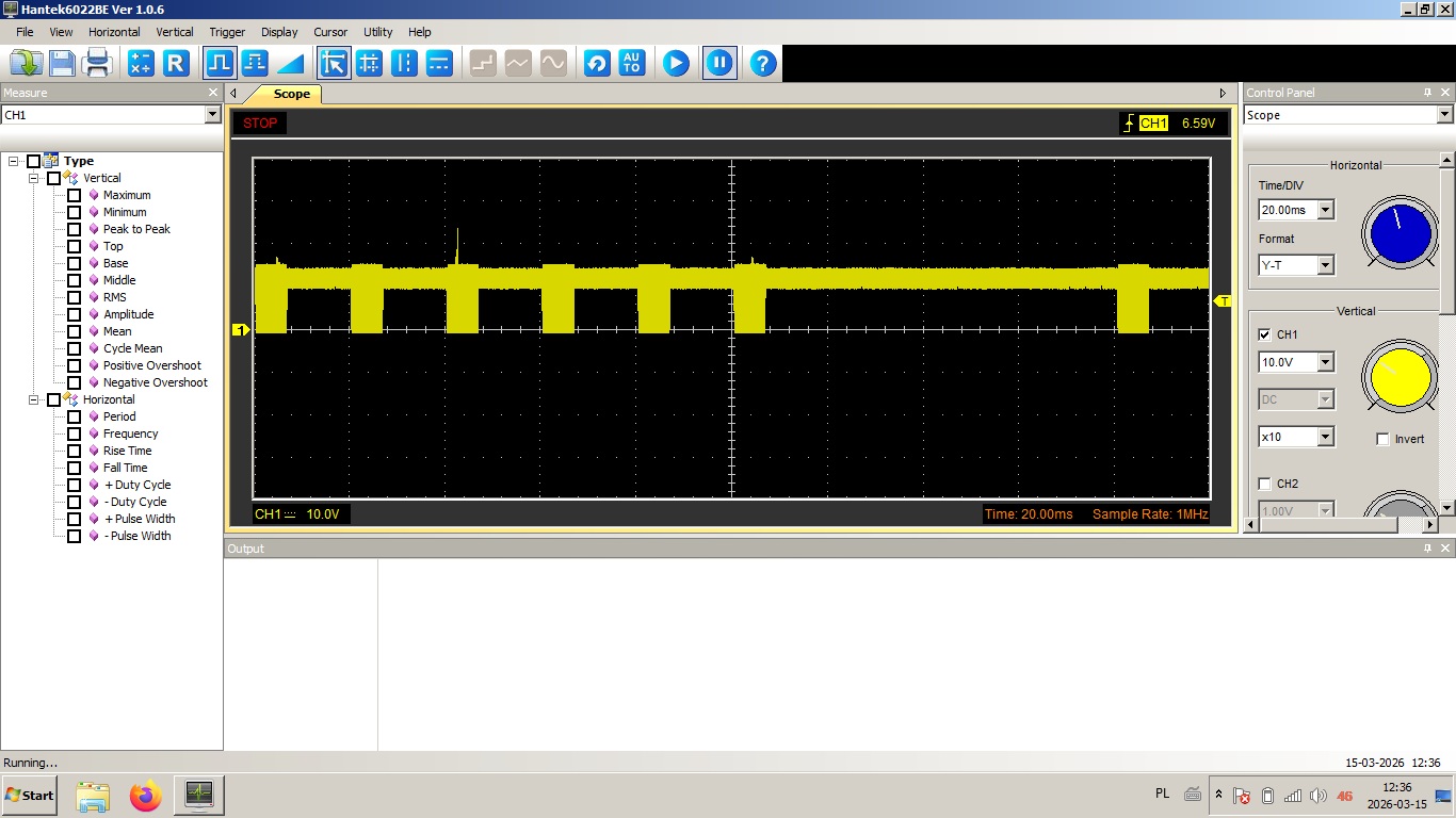

The problem
When measuring with oscilloscope it sometimes skips a sequence, or two, or one pulse is shorter than it should be, i can even hear this because whole thing works in audible frequency.
So i tried multiple takes to write this program, ai help, and nothing worked and i'm stuck at this.
Bez tytułu.jpg (222.48 KiB) Viewed 111 times
