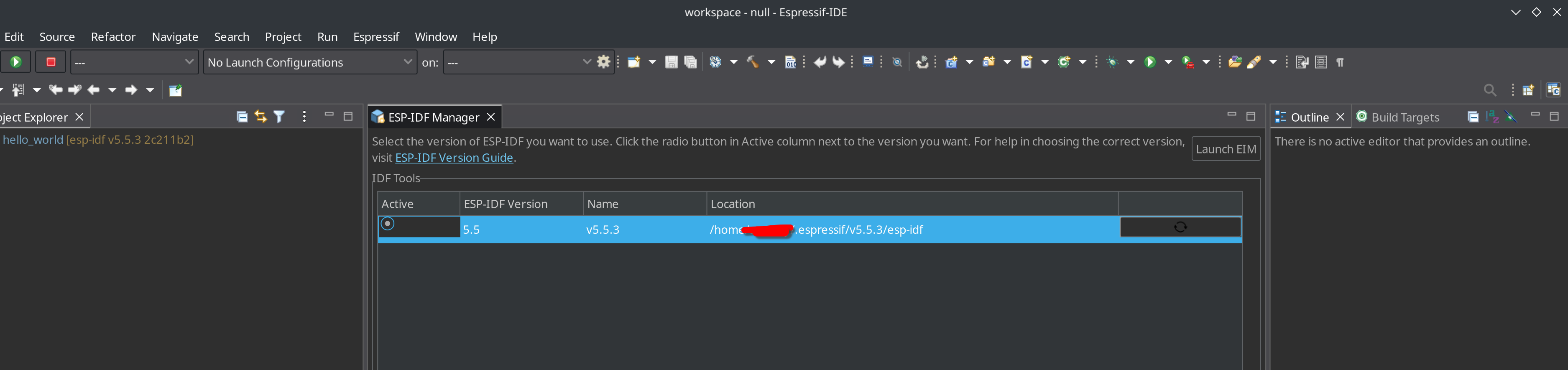

At the end of the Odyssey I've ended up with: an Eclipse IDE with Espressif plugin, the Espressiff official IDE and the IME tool with which I've ended up installing ANOTHER esp-idf toolset by mistake ("mistake" as in "following exactly the guide), located here:
/home/USER/.espressif/v5.5.3/esp-idf/
(see? exactly like the one I've already had, but duplicated in a different location).
At the end of the day, all these tools installed, plugins, official IDE and whatnot, they're still not enough because when I try to actually work on a project I get all kind of errors.
For example, on Eclipse+plugin if I try to build the "hello_world" example project found under the esp-idf directory, I get:
18:25:31 **** Incremental Build of configuration Default for project hello_world ****
make -j8 all
make: Nothing to be done for 'all'.
18:25:31 Build Finished. 0 errors, 0 warnings. (took 70ms)
I have activated the export.sh script, ran idf.py menuconfig, set env variables of the project etc. yet i can't build, I can't also neither "clean" nor flash nor anything, even though I've followed every step to the letter.
Same thing for the Espressif IDE, I get a slightly different error because on this one I didn't try an improvised solution:
19:08:57 **** Build of configuration Default for project hello_world ****
make -j8 all
make: *** No rule to make target 'all'.  Stop.
"make -j8 all" terminated with exit code 2. Build might be incomplete.
19:08:57 Build Failed. 1 errors, 0 warnings. (took 68ms)
(this was the same error I got on Eclipse IDE before I've tinkered with the settings).
Even though I've just got started I'm a fast learner, but the documentation is a maze and although I can keep working with the terminal I cannot give up the tools that those IDEs offer, so I need help to get things working.

I already have eim and Espressif IDE installed though
