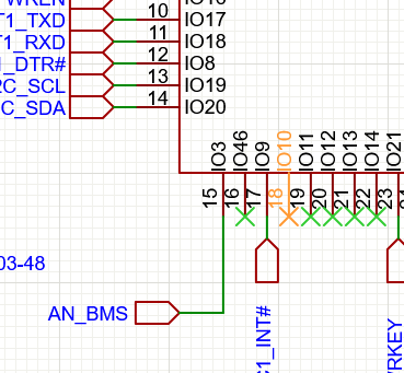

I am trying to read a 1 cell lithium ion battery voltage with ADC channel 2 at IO3 on esp32s3
the batt+ is connected to a voltage divider two 10k resistors then connected to IO3 pin.
Screenshot 2026-03-11 133832.png (8.67 KiB) Viewed 105 times
Screenshot 2026-03-11 135636.png (22.95 KiB) Viewed 105 times
The bug I encountered
before initializing the Pin as ADC input
the pin reads 2.1V which is normal on multi-meter.
after initializing as ADC by calling
analogReadMilliVolts(3);
the pin reads 3.6V to GND on multi-meter.
and it shows 3.2v in code
I know it shares JTAG pin MTMS but how does it effect the system?

I tried calling
gpio_reset_pin(GPIO_NUM_3);
before reading ADC values with no effect.
what could be the cause of this bug?
