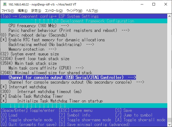

Using a variant "waveshare_esp32_s3_touch_amoled_241" I'm not have any success trying to read characters from stdin.
Starting with the "hello_world_main" example from ESP IDF, the following has been added as a task during the countdown:
void reader( void *pvParameters ) {
    printf("Reader . . \n");
    while ( 1 ) {
        char ch = getchar();
        if ( ch < 255 ) {
            printf("Read %c %d\n", ch, ch );
        vTaskDelay(5);
The line "Reader . ." is displayed, but then 255 is only ever returned by "getchar()", even with copious ponding on the serial console keyboard.

I tried your code complete, and again for me it's not indicating any data being received (I tried with both "screen" and "idf.py montitor"). The output of the ESP32 is displayed, but data sent to the ESP32 is not received.
That is puzzling.
What ESP32 are you using?
The Waveshare board being used as GPIO 19 and 20 connected directly to a USB-C port.
"idf.py flash" works, so it must be a configuration issue? :?
This setting is required for USB Serial/JTAG Controller Console.

Postby greggles » Sat Mar 14, 2026 11:49 am
Thank you! I must have missed than nuance in the documentation.
