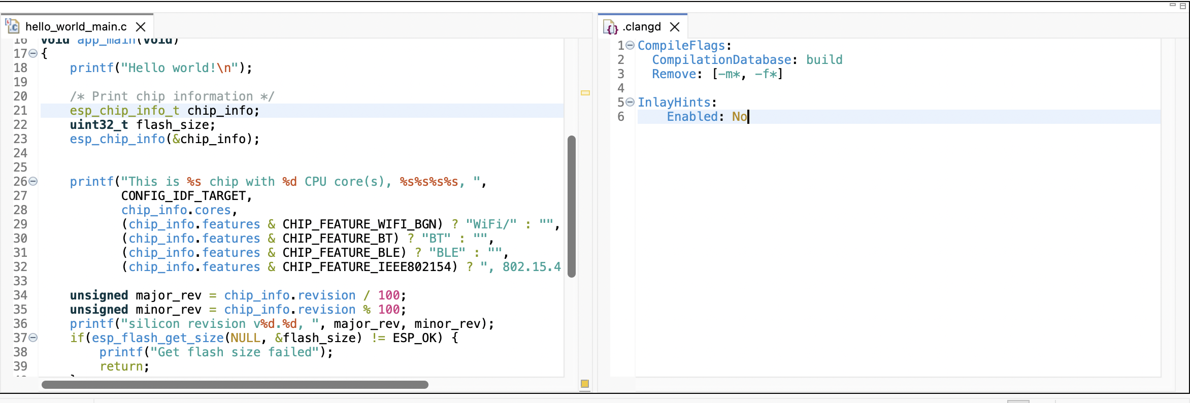

I have tried to find an answer both here and for the Eclipse IDE but I have not found the answer so far. I have turned nearly everything off in the Window > Preferences section and still get the description added to the code snippet below.
The italics is auto-filled and cannot be edited or even selected. It is a description of each variable determined by the IDE. I would prefer to put the command on one line, but this italics garbage takes up so much space I have to put it across lines.
Any tips?
xTaskCreate(&servo_mgmt,
		[i]pcName:[/i]"linear_servo",
		[i]usStackDepth:[/i]2048,
		[i]pvParameters:[/i]NULL,
		[i]uxPriority:[/i]5,
		[i]pxCreatedTask:[/i]NULL

The LSP Editor has inlay hints enabled by default. If you prefer not to use them, you can disable this feature by editing the .clangd file and adding InlayHints enabled status, please check below
https://docs.espressif.com/projects/esp ... nlay-hints
CompileFlags:
  CompilationDatabase: build
  Remove: [-m*, -f*]
InlayHints:
    Enabled: No

Thanks a milion, worked like a treat.
Strange dev choice (to me) to make it per project rather than global, but hey, it works.
