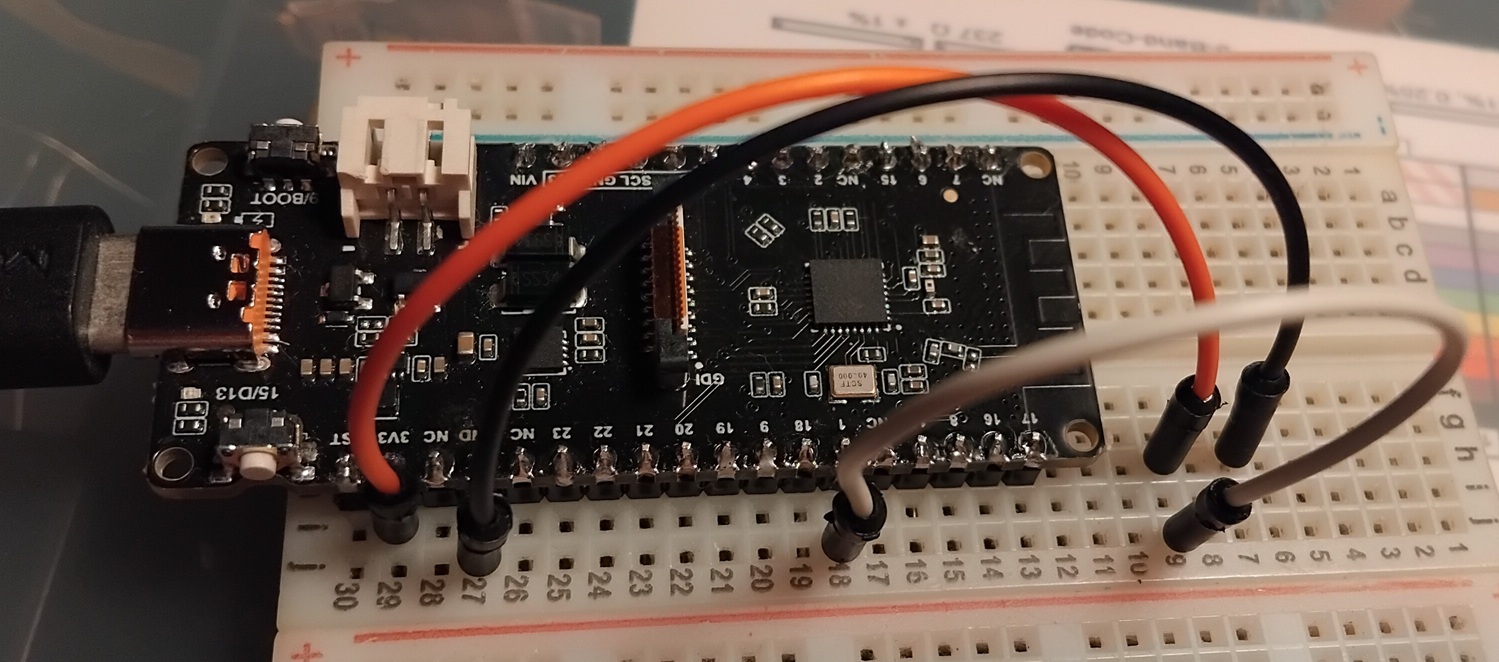

I am developing a FireBeetle2 ESP32-C6 Board.
https://www.dfrobot.com/product-2771.html
I tested the ADC on Pin 1 (set up as attachment). The output is far from the allowed 4095 value.

And the output from terminal are:
ADC analog value = 3262
ADC millivolts value = 3337
ADC analog value = 3269
ADC millivolts value = 3339
ADC analog value = 3256
ADC millivolts value = 3344
ADC analog value = 3275
ADC millivolts value = 3341
What is the cause? How should I improve and utilise the full ADC width?

The ADC SAR is factory calibrated, and a reference value is burned into the eFuses. So, using the analogReadMillivolts value is highly recommended to get accurate values, as it uses the calibration curves for the sensor.
The values will always be at their least accurate at the top and bottom of the range. To get better accuracy, you should use a voltage divider to ensure your expected values are not pegging the top of the range. To get better precision, you should set the attenuation as low as possible (ie, 0db) and have your input voltage divided into the 0-750mV range.

Re: ESP32-C6 ADC problem
Ok, thanks for your opinions.The ADC SAR is factory calibrated, and a reference value is burned into the eFuses. So, using the analogReadMillivolts value is highly recommended to get accurate values, as it uses the calibration curves for the sensor.
These are my new configuration of my ESP32-C6 ADC:
- Set the ADC in setup():
analogSetPinAttenuation(AN_Pot1, ADC_0db); - Use analogReadMilliVolts() instead of analogRead() to get the ADC voltage value.
- Add a potentiometer between 3.3V and Ground.
- Set the potentiometer to the point so that voltage on Pin #1 is close to 3.3V/5 = 1.65V.
- Limit the signal voltage in the range of 1.65V +/- 750mV
Please comment.
